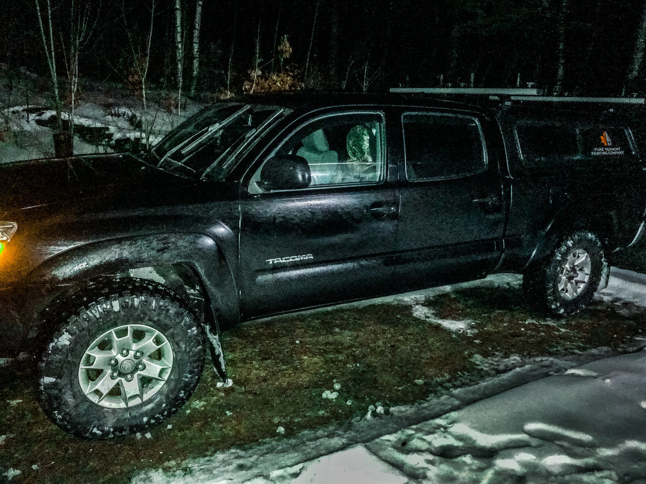

    Stock O/R no lift with 265/75R16. No rubbing at all.[​IMG]
    Stan76[OP] likes this.

    DEC14140-5104-441E-B152-01180DCDCBBD.jpg She’s done.
    Minny Taco, Pigpen and scottalot like this.

    Rides really nice. A bit to get used to after having 245/75/16 Cooper discoverers. Lol
    scottalot likes this.

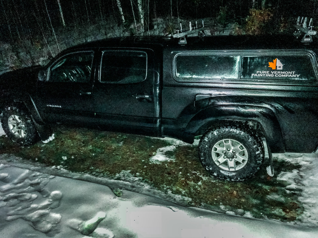

    So as you can see, with stock rims you’re fine. With aftermarket wider or different offset rims, you might need to remove flaps. I did when I went to SCS rims with 0 offset.
    scottalot and Stan76[OP] like this.
