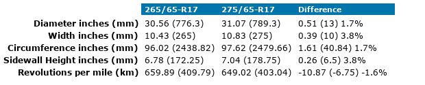

    here is the tire comparison from stock

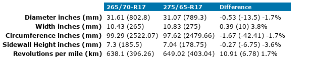

    and here is the comparison between 265 70 vs 275 65
    The 275 65 17 is smaller by .53
    but the width is wider by .39

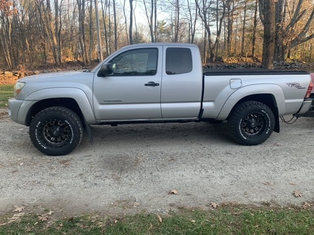

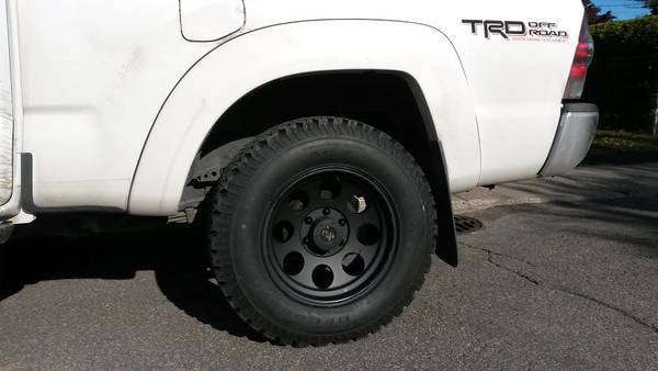

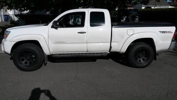

    275 65 17 Bf A/T ko
    small trim at the back of the front fender and flaps removed.

    slight front flaps rub
    275 65 17 on pro comp 7069

    So is your truck all stock? With those 275/65/17 wheels?

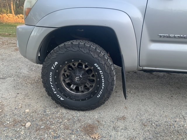

    I put on 275/65r17 onto my 17 X 9 rims with a +1 offset. I have a leveling kit on it and it doesn’t rub at all and had to do no trimming. The tires were BF GoodRich KO2
    Based on the two pictures, I would say the white truck above doesn’t have a leveling kit or lift on it. I would highly recommend doing a leveling kit if you are getting wider rims. 17 x 8 rims may be okay but maybe some trimming.

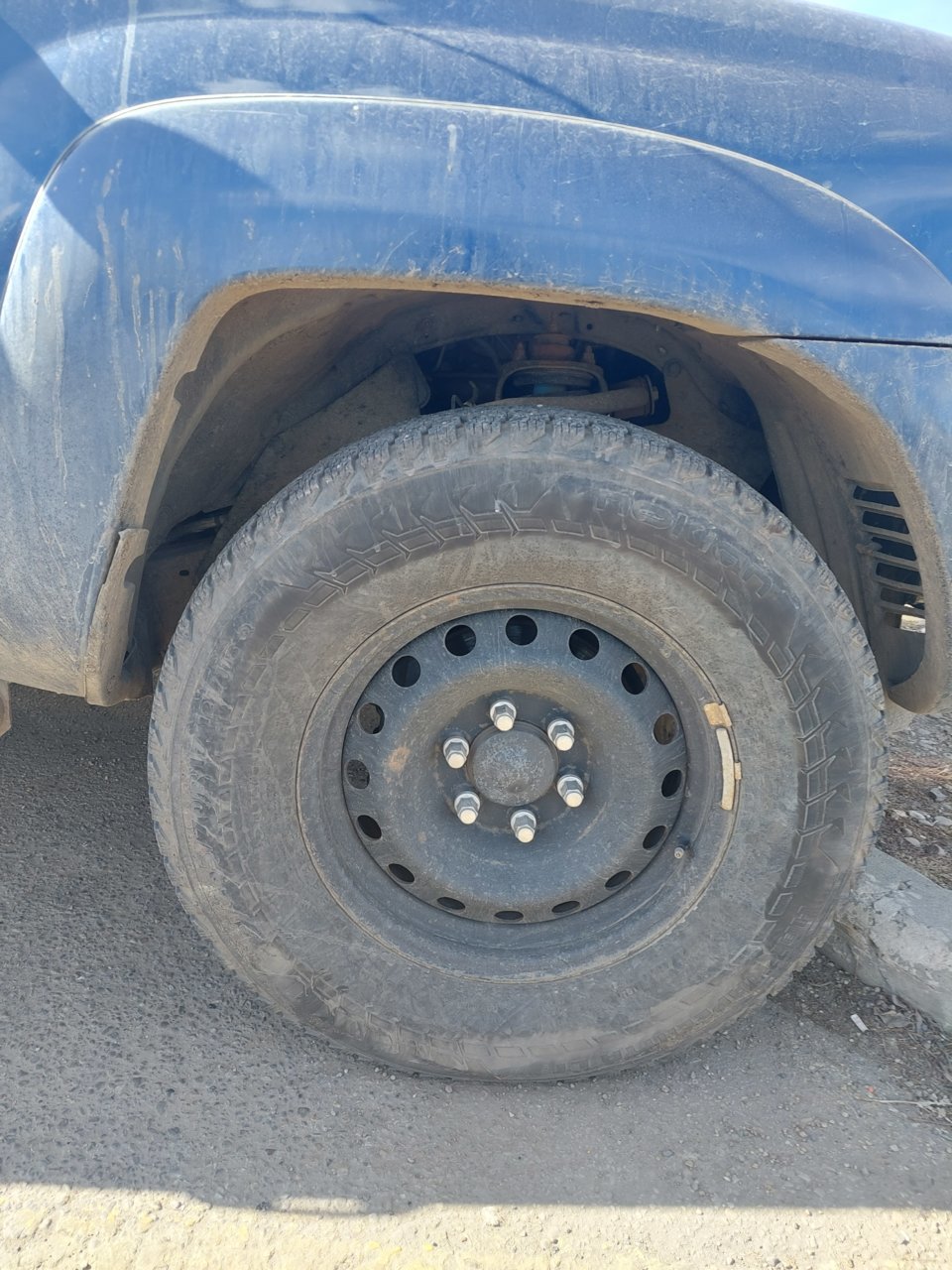

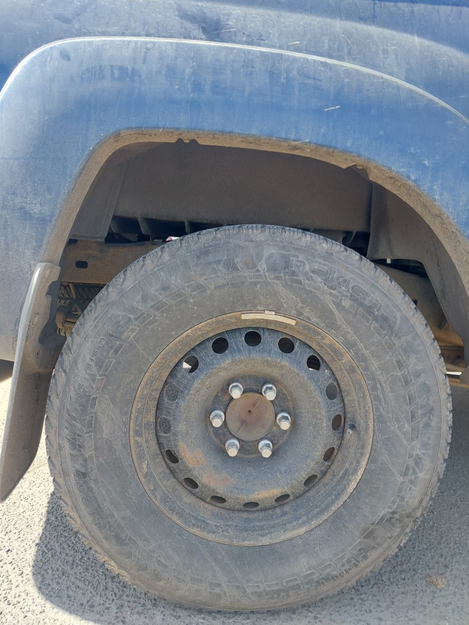

    I have a 2006 tacoma stock ride height, I currently have 265/70r17 experience a little bit of rubbing in the front end when turning, as you mentioned up there the 275/65r17 are half an inch smaller so it wouldn't rub on the fender thing when turning I'd assume, one thing I don't like with 265/70r17 is that it looks too big for its width, like a bicycle tire
    The first photo is the rear and second is the front both on 265/70r17
