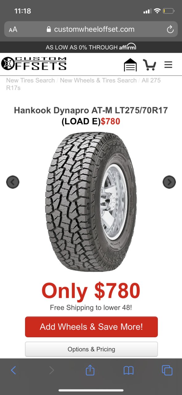

    This is the tire I’m going with

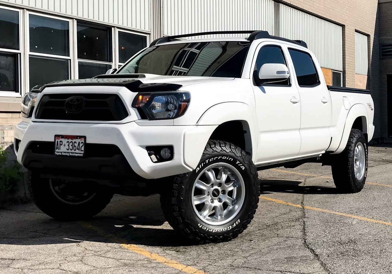

    I ran 275-70-18 on a 18x9 wheel with no issues.

    275-70-18 was a true 33” tire, fuel economy and gearing was good, no complaints lol! Ask me after I slap on the 35’s lol!

    Nice looking truck!
    That's good to hear. If you were ok with the ~33 then I guess I should be good with a ~32.

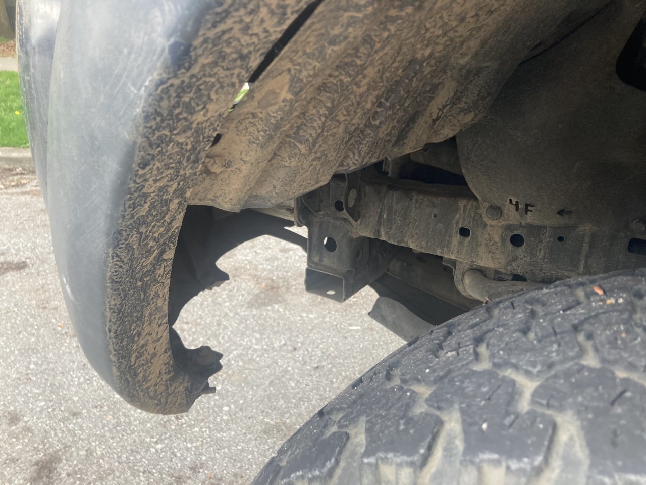

    1.5in levelling kit and 1.5in wheel spacer.
    Only rubbing is this fender liner. When the wheel is hard over to one side or the other. Small trim is all.
    Nothing that requires cutting the Cab mounts like on my FJ.
