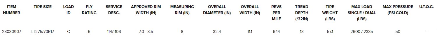

    Falken makes a 275/70R17 in a C rating. I'm running them on my TRD Sema wheels. Get a tune, 100% worth it.

    Yes I saw that, but at 57 lbs that’s a lot for a C rated tire. I’m considering those but I’d feel better going with something lighter. How much power did you feel you lost going to that tire?

    I think a lift would help fit those wheels, but it might fit without, and only require minor trimming and mud flap/air damn removal. Look up the official 275/70R17 tire thread on this forum. I’ve read through almost the whole thing. There is a guy on there with a 2” TRD lift kit the 17x7 TRD SEMA wheels and 275’s, and I think he was able to keep the mudflap. Those wheels seem to be the best way to fit 275’s since they are 17x7 +4 offset compared to the 17x7.5 +30 offset TRD sport rims.
