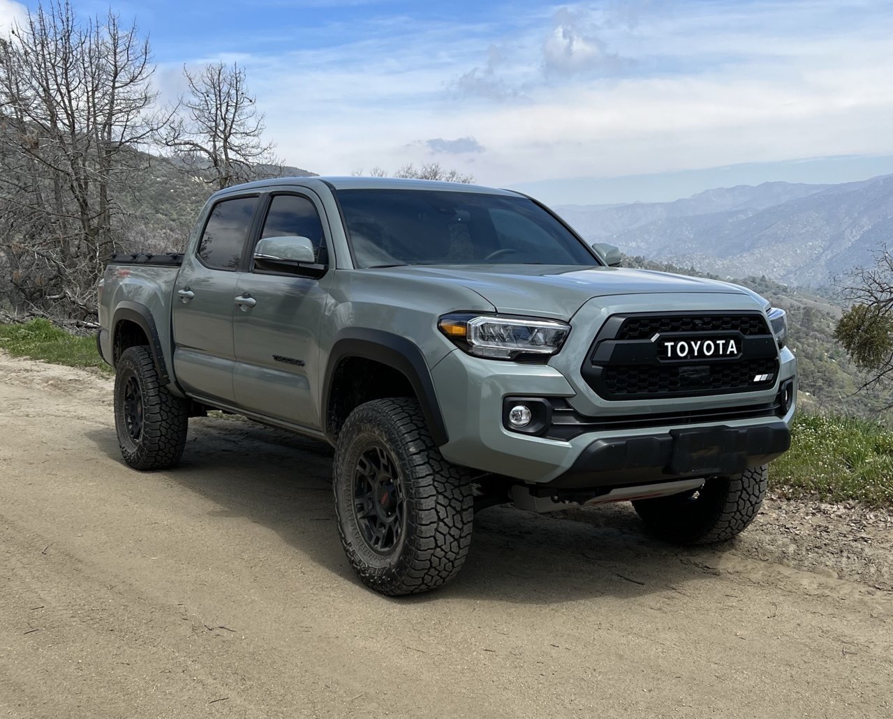

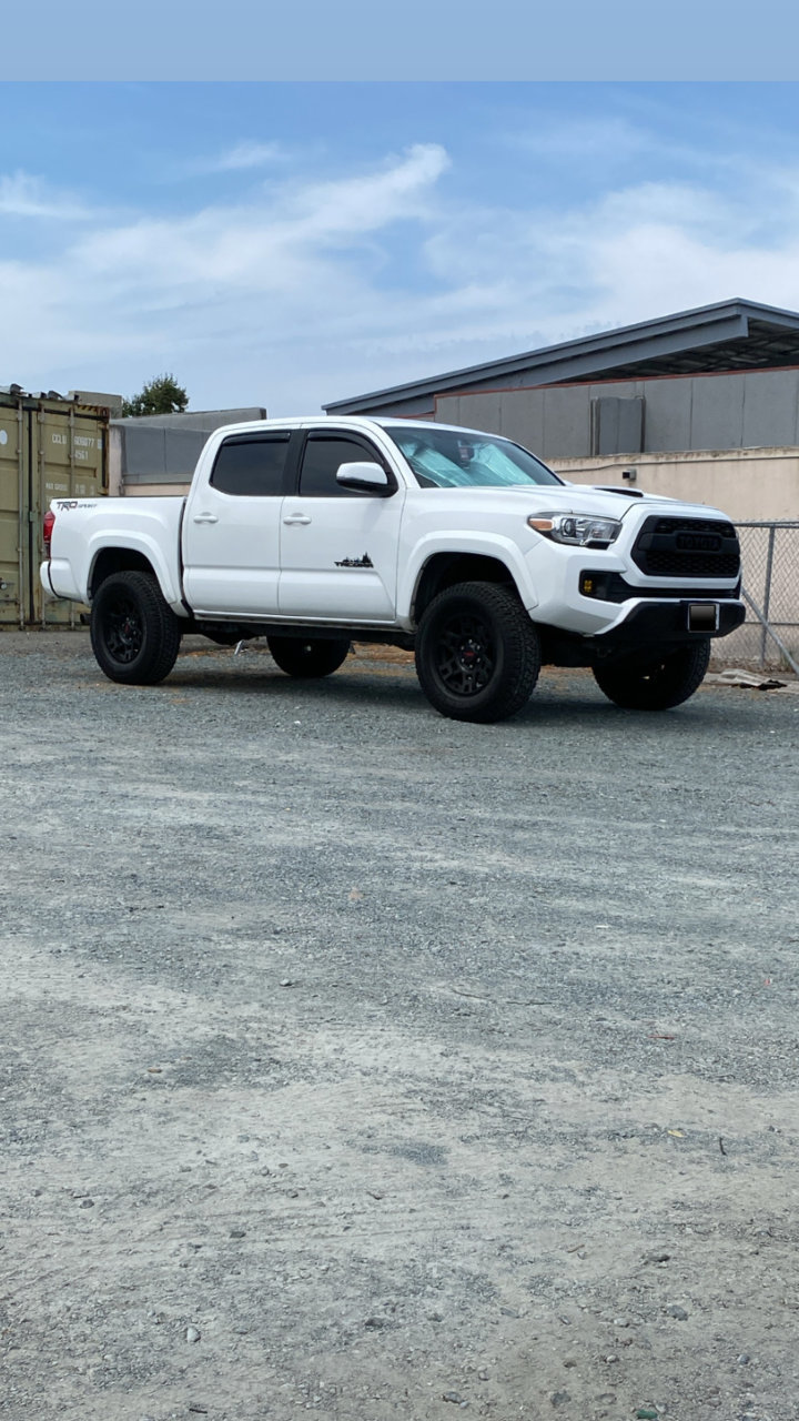

    I run 275/70r17 Wildpeaks on mine. I have the TRD lift so it’s about 1.5” ish. Like the post above states though, lift is only a piece of the puzzle with rubbing with tire size. There’s a million forums on here diving into it. I’ve had zero issue on rubbing paired with the 4Runner Pro wheels. I have no mudflaps though, but I haven’t trimmed at all.
    What would it be like at full lock crawling? Idk, if I get there I’ll let you know lol. For my purposes (ie mostly forest roads at worst) I have had no issues and love the tire size. I pull about 16 mpg give or take and I’m mostly city driving on my commute.
