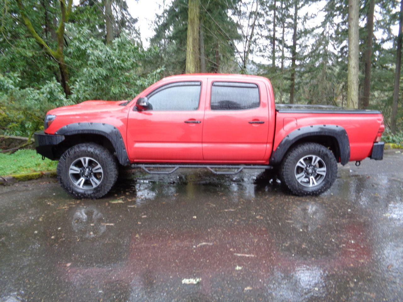

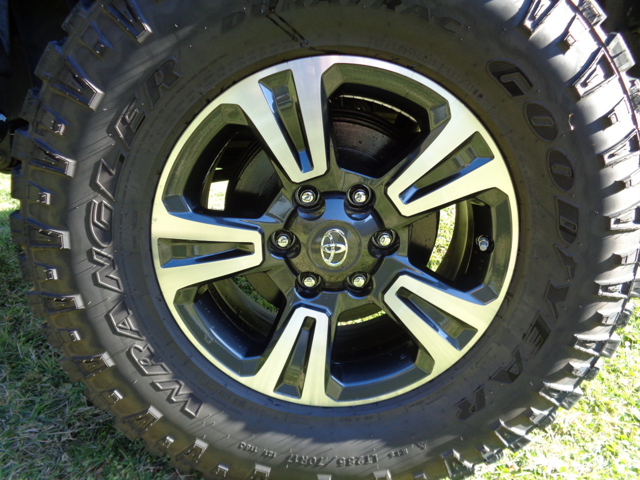

    I have 285/70/17 goodyear duratrack's. 1 inch wheel spacers, 3 inch lift, they rub a little when tight turning. I got 22mpg on a trip to oly and back about a hundred miles. I filled up before leaving and filled up when i got back. The mileage lost was in the tire diameter, the truck records less miles. So I used gps to calculate mileage. My truck has 172,000 miles. I am very happy with how it does on the road for a 4x4 and an automatic.DSC00303.jpg DSC00740.jpg
