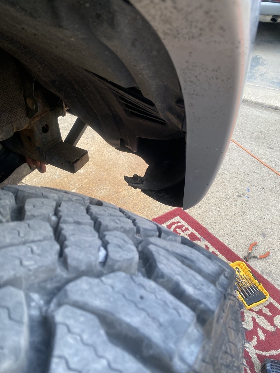

    Yea I'm very fond of mechanical work. I replaced every piece of steering and suspension 2 years ago in my rig as I do quite a but of overlanding in it plus it's my daily. I'm just trying to figure out my next step in the build. 33's aren't needed but it would be nice to fit them on the truck but it looks like I'll have more work to do before I get there

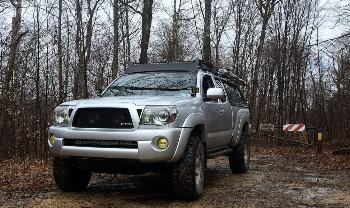

    My current setup

    They may not rub driving in the mall parking lot, but the minute you hit a bump with the wheel turned, they will. Do it right. You keep adding pressure to those bilsteins with those springs you have, and you may as well drive a chuck wagon cause that what it will feel like.

    Hence the reason for this post. I've driven my truck with current setup for almost 3 years and have had rubbing issues. I love the mall comment. Nagging aside, I have OME heavy duty coil springs around my 5100's. And I also have an add a leaf set with Timbren active bump stops in the rear. With that said I have no sag in the rear even with the gear I have on my truck. If I add more weight then the bump stops handle that weight very well. I plan on doing it right one day.

    This looks like a 1.5” spacer which would yield 2.5-3” of lift in the front not 1.5” lift.

    Thats the front it is a level plus 1.5. sorry didnt clarify.
