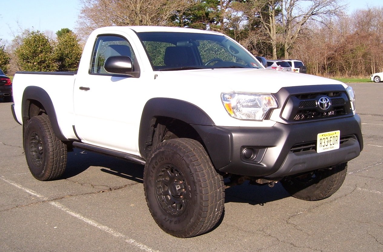

    I have OME 885's with Nitro shocks (around 3" lift) with aal in the rear, SPC UCA's and Pro Comp 16x8 with 4.5 bs 0 offset and there was no need for a cmc. The flares have been trimmed a little.
