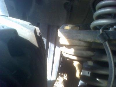

    I've got the LR UCAs with aftermarket rims (4.5" bs). I've got about 1 1/2" - 2" of space between the tire (285) and the UCA. I'll post a pic when I get home.

    Wow, that's alot of clearance!

    Stock rims would be about another inch closer.
