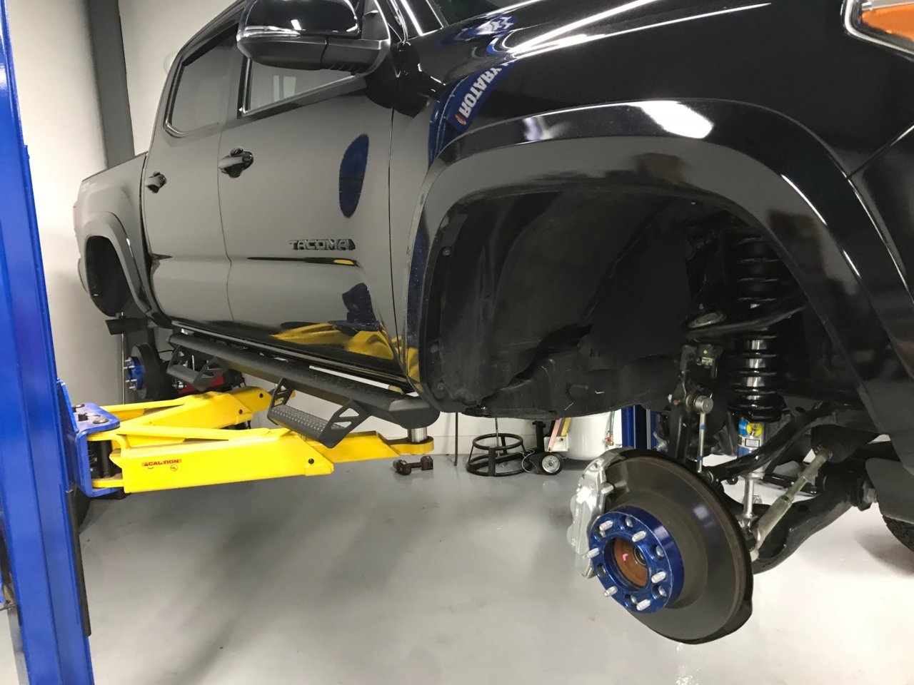

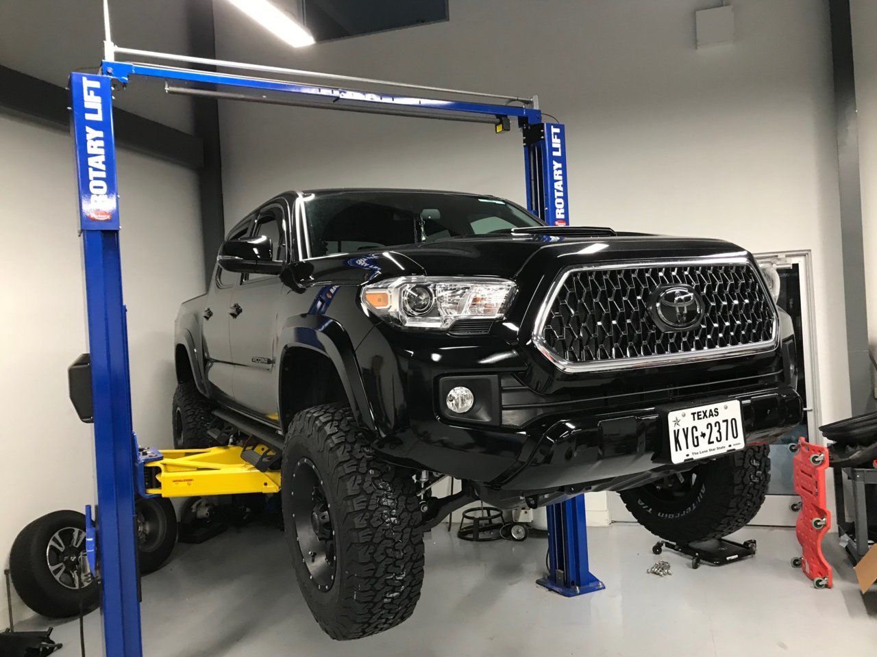

    I have 17x9 +0 w/ BFG KO2 285/70/17... 5100's set 0 w/ 2887 OME and spacers 1.25" but you will have rub big time!.. last night I took them away and problem solved... no rub at all... no to much difference...
    This picture without spacers

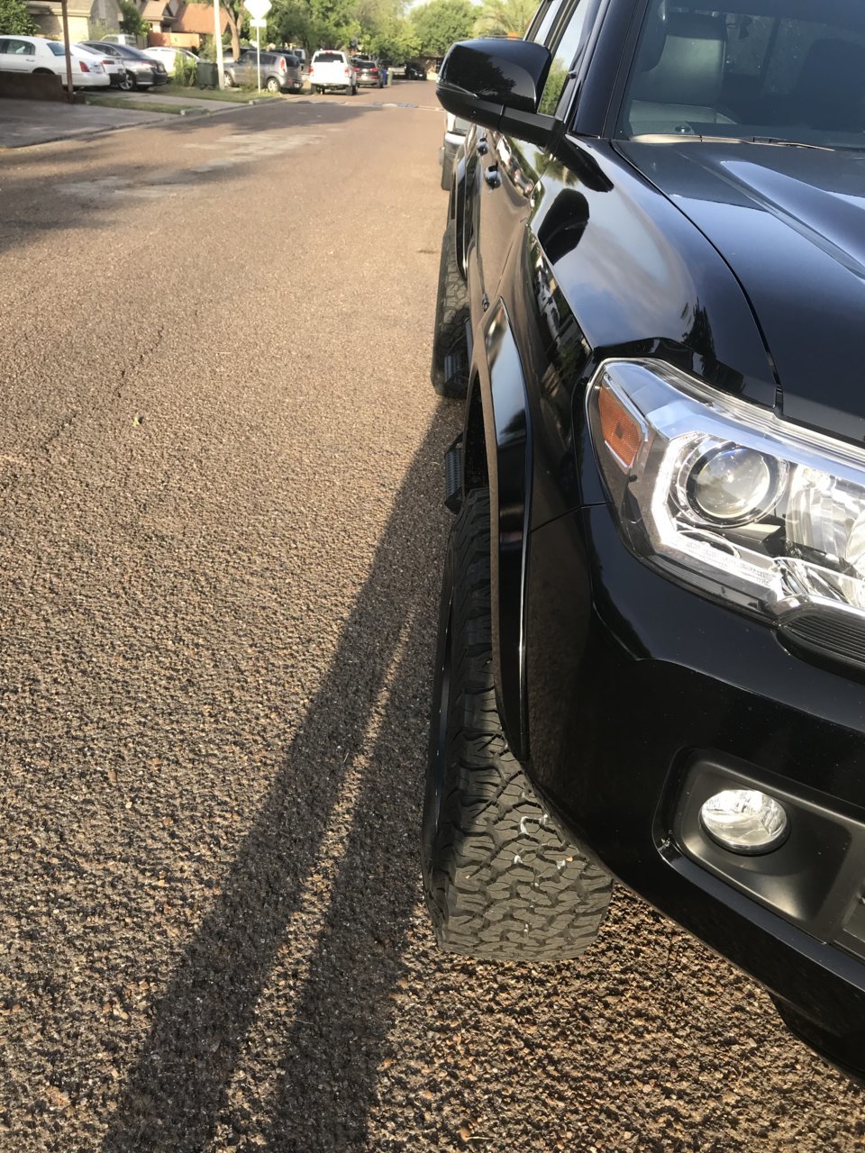

    Hope this will help..

    Yes thank you, It doesn't look like it sticks out past the flares too much. If you remember, how far would you guess? maybe .25"?

    I think it was like 2'' out of the flare..

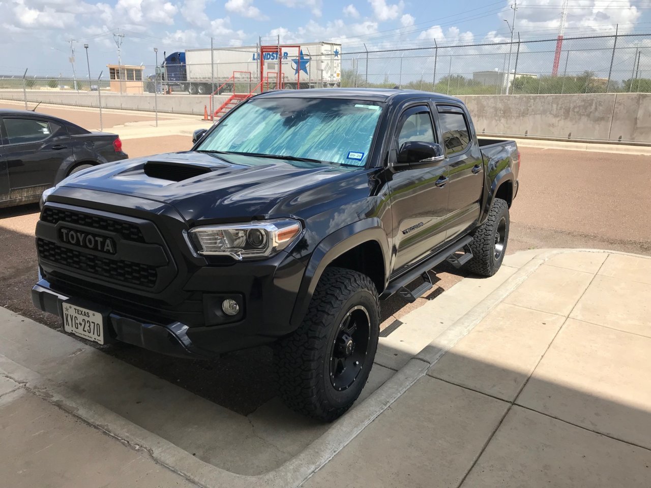

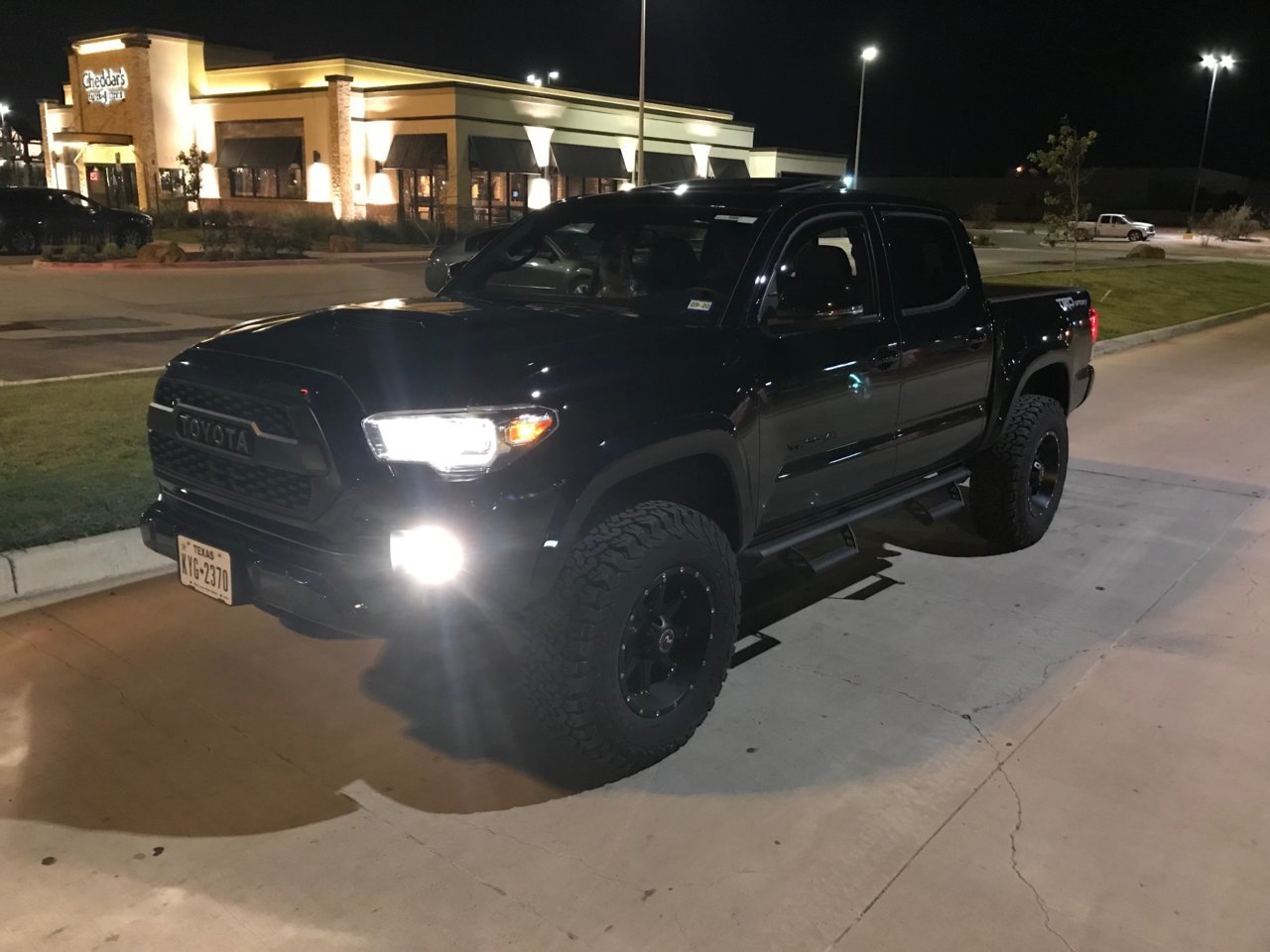

    I didn't take pictures to see it, but for me it looks like 2''... I will try to put them back on... I let you know..
