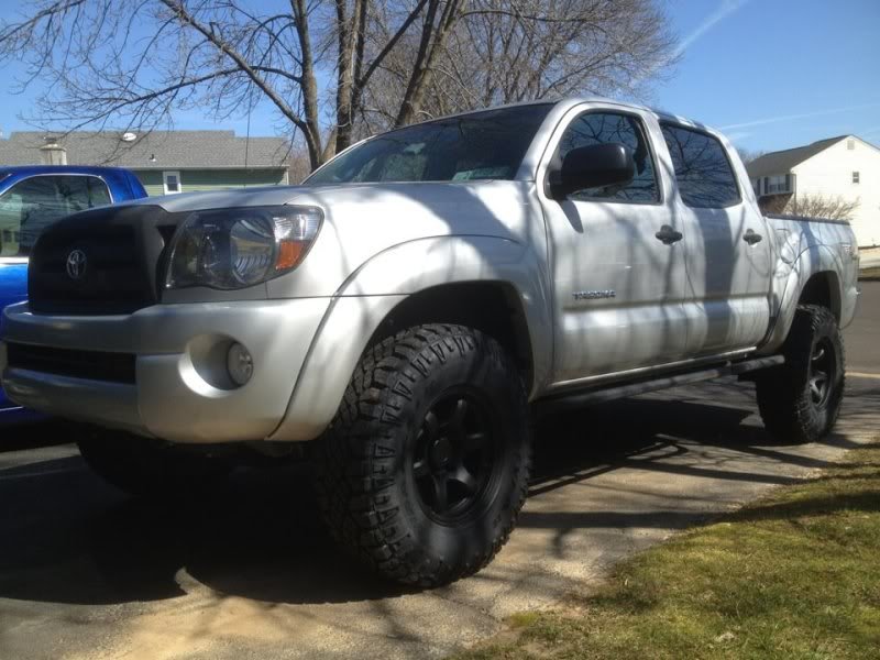

    I know it's been asked many times, but I have a toytec suspenison lift set at 2.5" in front and 2" AAL in the rear. I just want to fill my rear well a little more because it makes the rear wheel and tire look small, but at the same time, I wonder if going to 285s will look too big for the front wells. Should I stay with these 265/75/16s or go with 285s? And will it effect my gas mileage much? These tires are maxxis bighorn tires and I'm planning on going the duratracs route for my next set. So it would be going from MT to AT. Here is a pic of my truck from the side:

    Well the size looks fine in person, but in picture, they look small. Do you all think it looks fine? I just don't want to trim a lot if I got 285s.

    Looks fine to me. I run the same size tires with the same amount of lift as you.

    I think your 265s look fine but Iknow your tempted to go to 285s they would great but you would around 3 miles to the gallon and probably a little handling to at least I did
