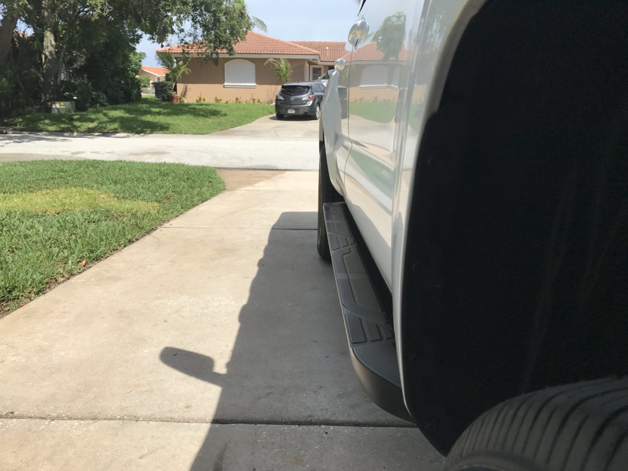

    I've got that exact part number on my '17 DCSB SR. Direct bolt on, no modifications. 10 minutes per side.

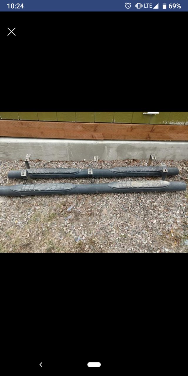

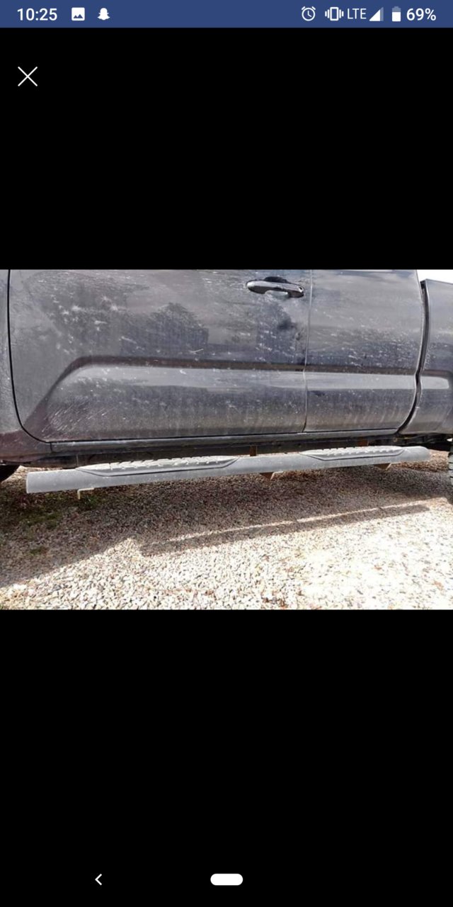

    Does anyone know if the reverse of this will work? I found a set of used access cab steps that are from a 3rd gen, thinking they should bolt right onto a 2nd gen access cab?

    Pictures of them if it helps

    If the 2nd gen boards fit on the 3rd gen, I see no reason why the reverse wouldn't be valid.
