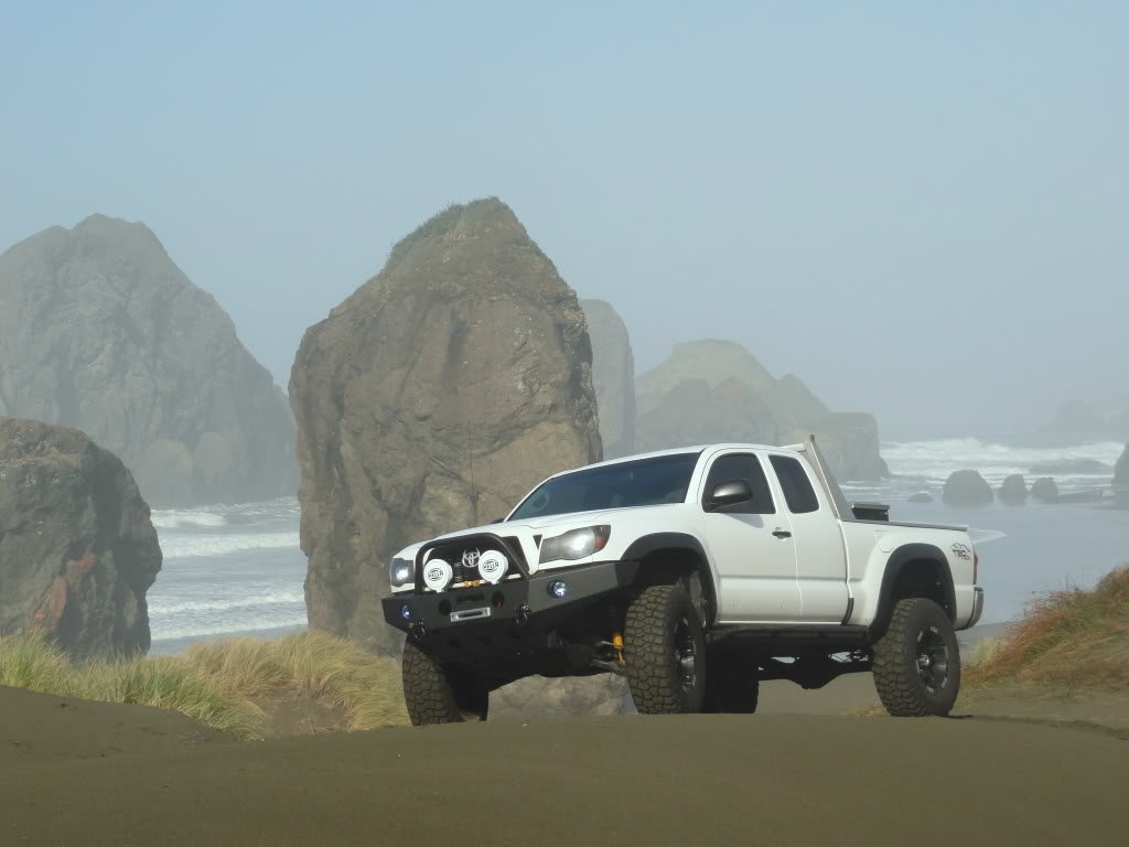

    With lots of trimming and still a little rub, yes 35's fit.
    Here is my old 2nd gen on 3" lift and 35x12.50x17 KM2s, granted it was after cutting 2" out of the fenders as well to get rid of 90% of rubbing.
    And before cutting out the fenders, rubbed a lot more.

    No amount of lift will clear it if you plan of stuffing them.....you have to make more room in the wheel wells!
