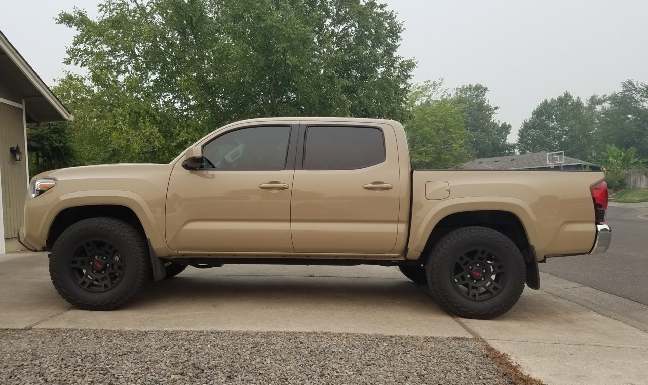

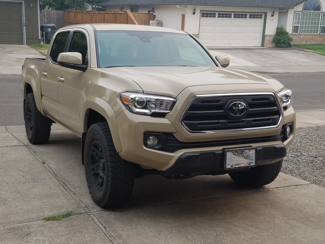

    2.7 with 265/70-17 Falken Wildpeak A/T3W Great tire. Quiet, great on wet roads. I live in Oregon and have been all over dirt forest service roads back in the mountains and never had any problems. I have a 2wd SR5. I took the front air dam off and with the tires and 4runner wheels i get about 1 mpg less than with stock tires/wheels and air dam.

    Nice truck. I have the same tires

    Negligible power loss with the 265/70-17 Falken Wildpeaks. Also no lift.

    It looks really good! I will be relocating to the Oregon/Washington area. I used to live in Clark county for 10 years. So you didn’t notice any sluggishness on hills/freeway (any more than the 4cyl already has with the stock tires?)

    The difference on the highway compared to the stock tires was negligible. Around town it was not noticeable at all. I like the way the truck drives and handles better with the Falken Wildpeaks over stock tires. I do hate the transmission on the mountain passes, the way it shifts, but it did that with stock tires and wheels. It will keep up speed if you give it gas it just downshifts on the steep grades to 4th. It did that with the stock tires also. I don't know it the TSB that is out is also for the 2.7.

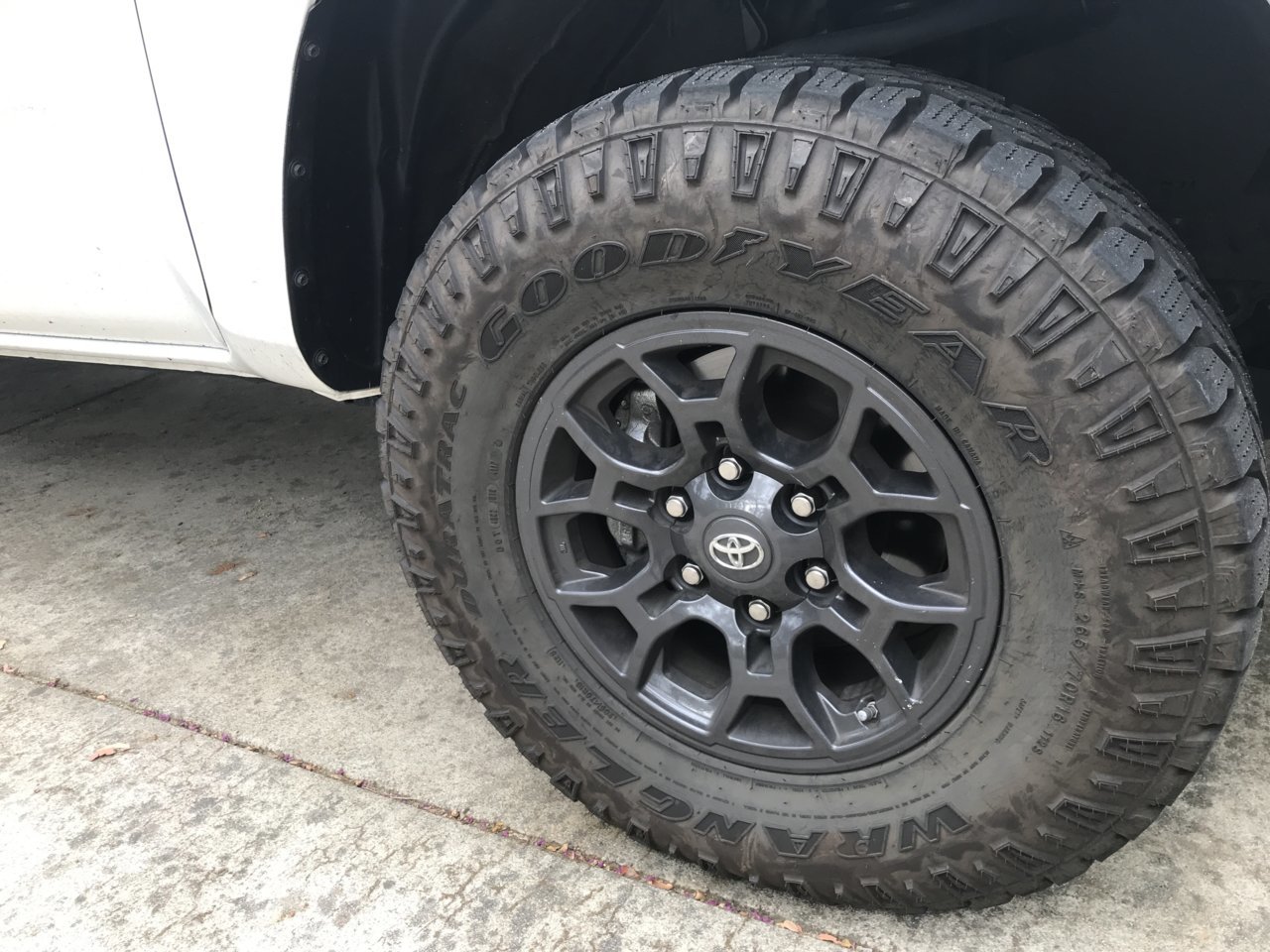

    I switched out my steel rims for oem Toyota alloy and went with 265/70-16 Goodyear duratracs. I did not want to do a lift or any modifications to the the suspension but the new tire setup looks much better and performed in the snow really good. I have a MT and did not lose any power that I can tell but I have no idea about an automatic transmission.
