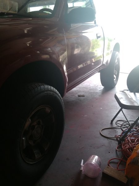

    I want to get a set of 31x10.50 tires for this thing and I was wondering if they would fit with no rubbing the trucks 4x4 and It has a lift but idk how much take a look at the picture and tell me what ya think.

    Here's the pic

    The fenders aren't really the problem but its the shocks that I'm worried about

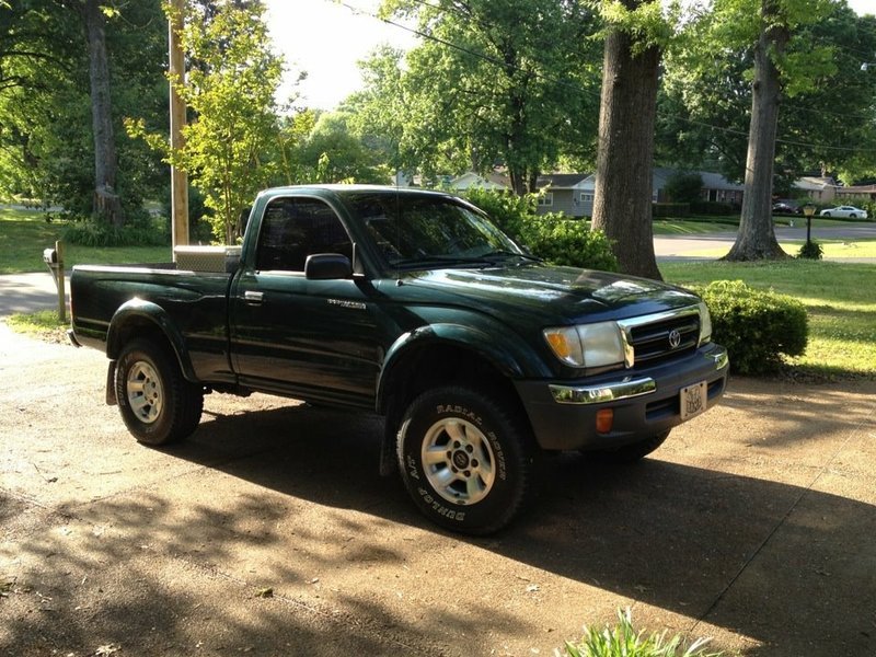

    Yes. Here is mine, too.

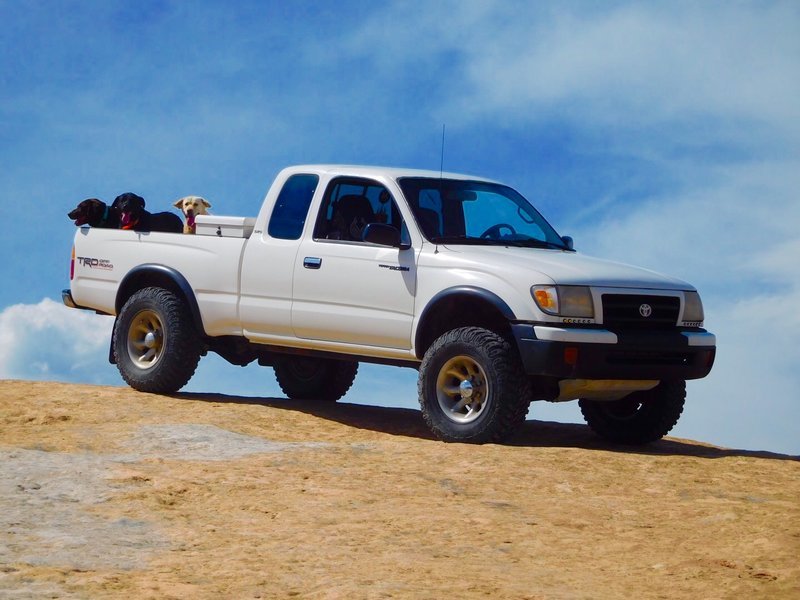

    This is lifted somewhat
