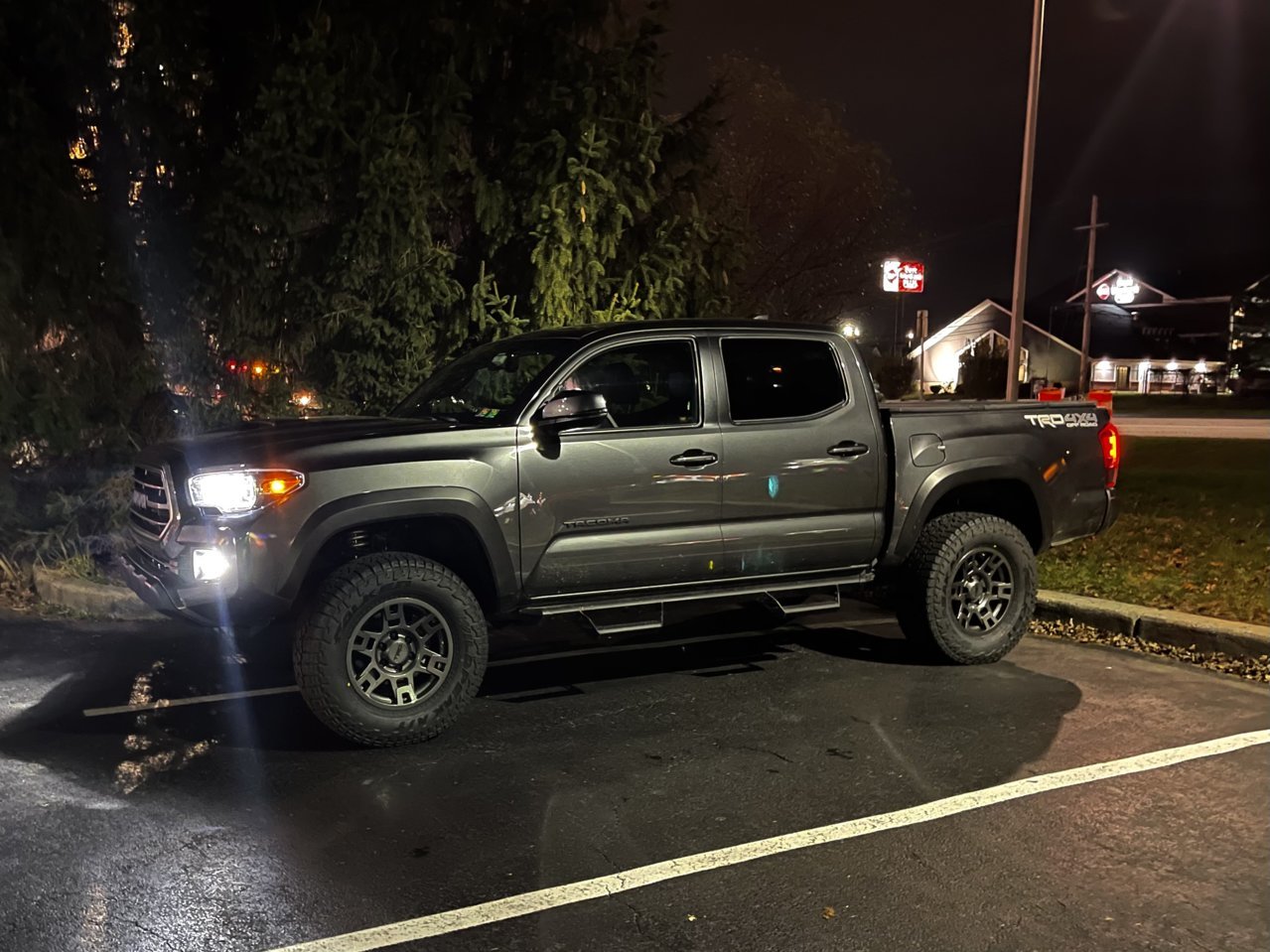

    175E7FA1-2F42-466A-8C04-6303308D59F3.jpg Just get some 275/70 Wildpeaks and enjoy life.

    I fucking love this truck. Put a SSO bumper on it last week. Need a new pic. :cheers:

    I hear ya. I saw some 275/70/17 wildpeaks. They are a little bigger that my 265/75/16. Kinda that in between size that may not rub.

    I just saw these on a truck at Lowes. They looked good!!
    OMGitsme[QUOTED] likes this.

    Your truck looks good. What size lift?
