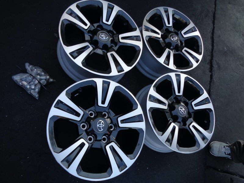

    I have this 03 TRD 4x4
    Would like to put these wheels on them.
    Other than going from 16" to 17" and the speedo being off, will these bolt up without any backspacing issues? I don't want them to stick out all funny ya know :)

    Yes they will fit. not sure on what the back spacing is for those wheels as they are 3rd Gen wheels. I believe they actually have a little more(sit in farther) than 1st Gen wheels. Here is a guys that has 3rd Gen wheels on his '03 https://www.tacomaworld.com/threads/2016-wheels-on-the-04.421856/

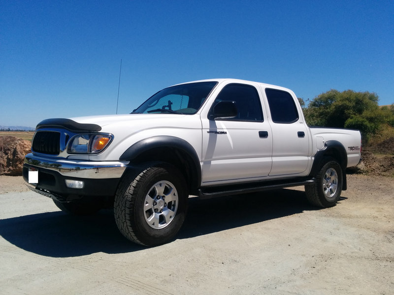

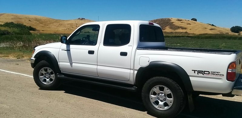

    For the record, the 2nd Gen off road look the best on a 1st gen white doublecab :)
    EDIT (3/21/19):. Ended up dumping these wheels. Just too much frame rub at full lock. Wheels look awesome, backspacing on 2nd/3rd gen wheels sucks for us.
    Go back to the stock wheels or something with close to 4.5 backspacing Also the post below is a great alternative @ 4.625 backspace.

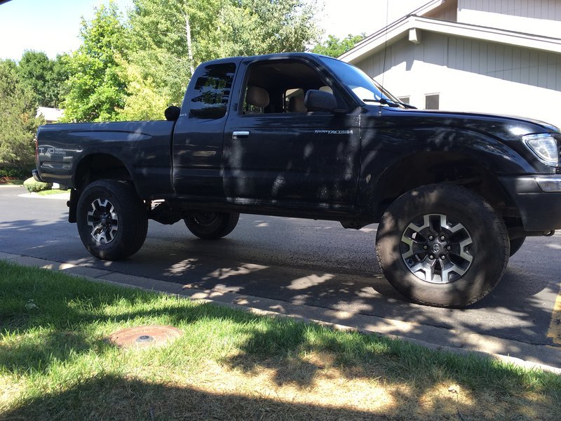

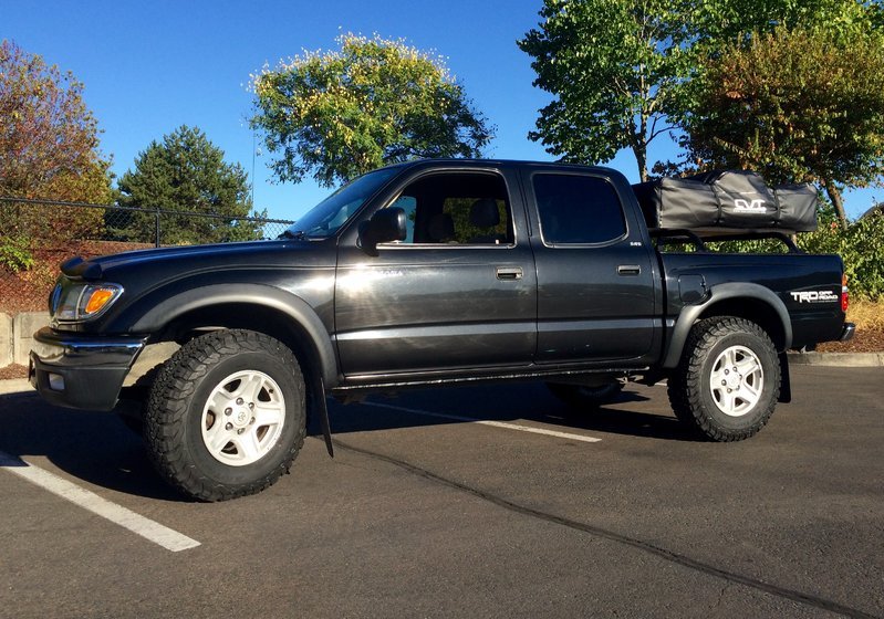

    You can also run 3rd Gen 4Runner wheels as well.

    Ohhhhhhhh
    Me likey.
    That looks great! As I was walking through the parking lot in to work this morning Isaw a 2nd gen with those exact wheels and wondered how they would look.
    Thanks for the pics!

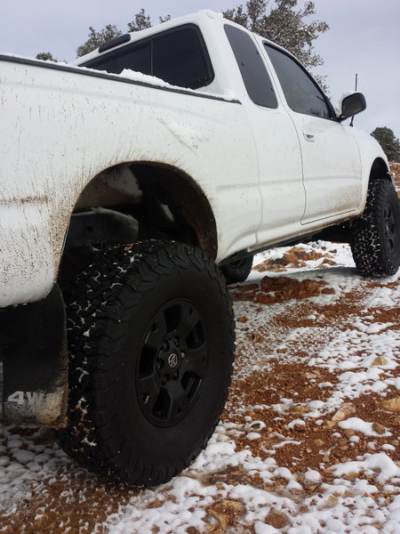

    2016 trd offroad. I like 'em!

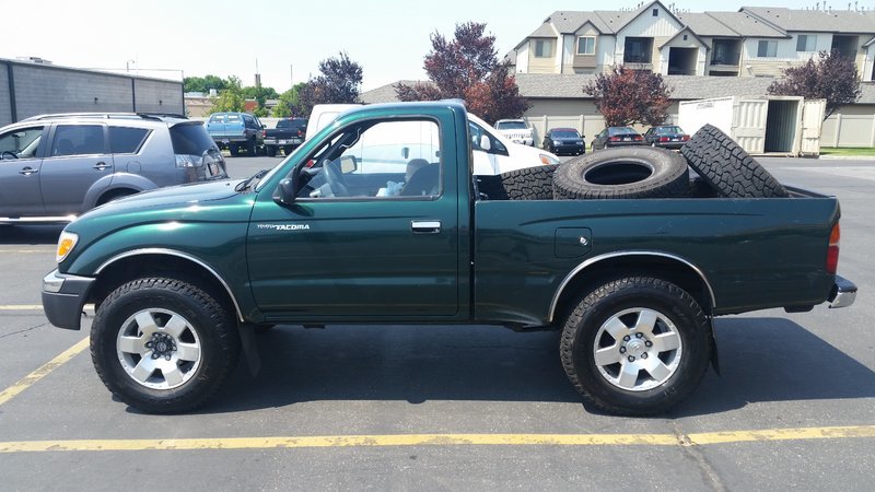

    Fj wheels
    Not my truck, but i am getting the same wheels this weekend!

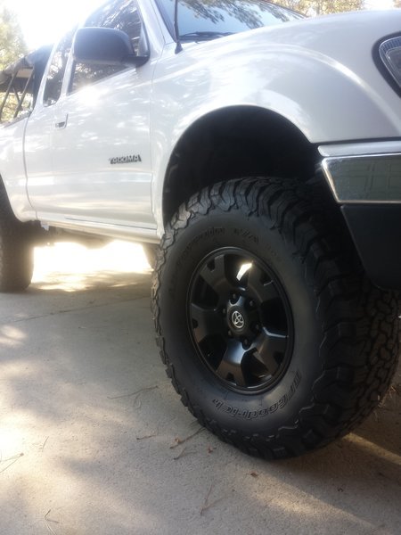

    2nd Gen OR wheels, powder coated black.

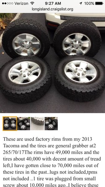

    Hi guys,
    New member here. I have an 02 crew cab and I'm looking to upgrade my wheels.
    Will these 13 17" wheels fit my truck with no issues? Is the gas mileage affect dramatically by in creasing the wheel size?

    The wheels will bolt up no problem. That tire size will rub the fame on those wheels at full lock.

    Will a smaller tire size solve that issue?

    Yes. You are at a slight disadvantage because those wheels sit 10mm further inboard than stock. A 265/65r17 shouldnt rub.
