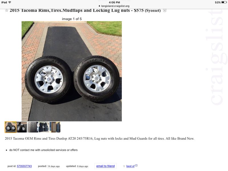

    So the tires on CL were already sold. BUT, I found another set that are 2015, 16" with 245/75R16 tires. My 02 is running 16"s as well. Wil these be a perfect fit?

    Have any pics?

    This is the ad.

    Those are the TRD off road wheels....will bolt right up no issues.

    X2. The tires will be fine.

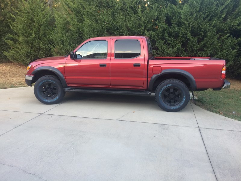

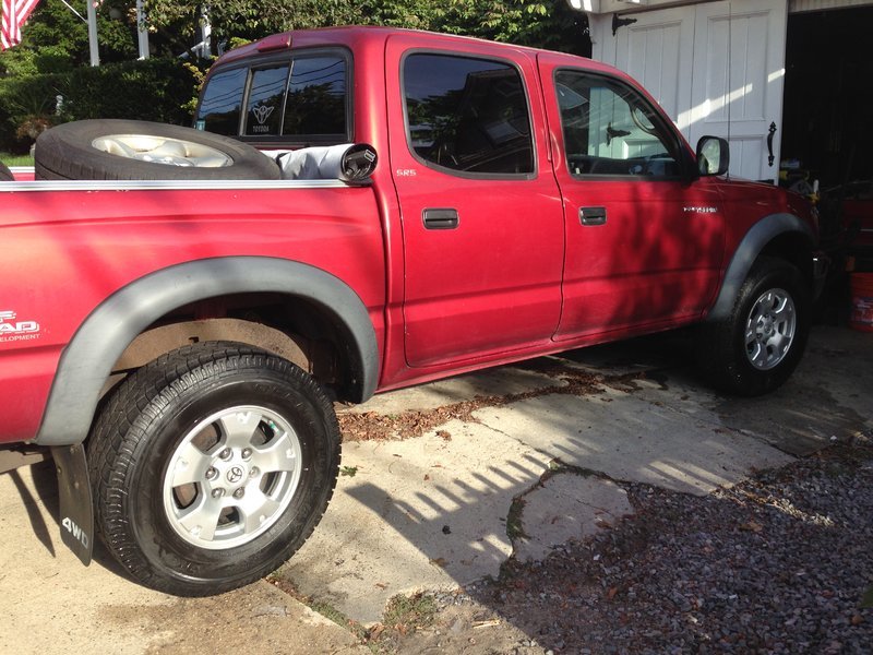

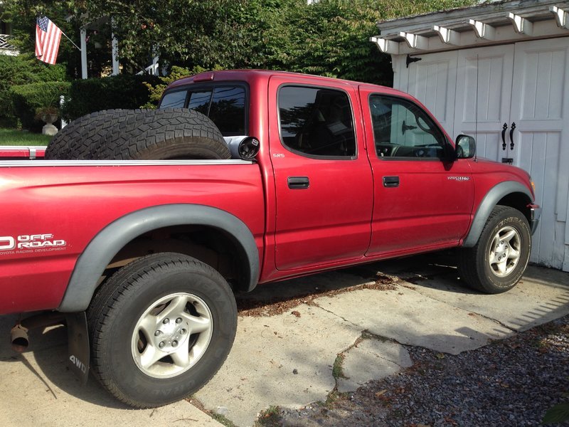

    image.jpg image.jpg Fit perfectly!!! I'm loving the updated look. Now on to a new rear bumper. Thanks for all the info!
    Before and after pics.

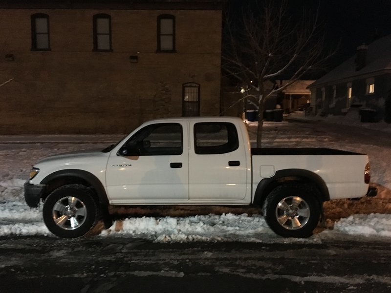

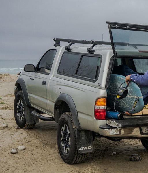

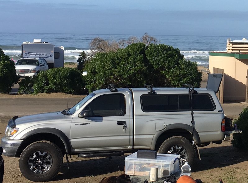

    About to pull the trigger on the 2016 TRD OR wheels for my first gen. I want to swap my current 265/75 R16s onto the new wheels. Anyone know if they will run with the slightly larger tire with the 10mm diff in back spacing?
  14. Feb 8, 2017 at 2:47 PM
    #34
    couplefunones
    couplefunones Well-Known Member
    Mar 18, 2016
    #181609
    93
    I have that set up right now with 5100s at first notch + add a leaf in the rear/5100. Reverse fully turned going over uneven ground it rubbed slightly (i know rare situation..) Nothing major, definatly tolerable.
  15. Feb 8, 2017 at 2:59 PM
    #35
    topochicotaco
    topochicotaco New Member
    Apr 29, 2016
    #185680
    4
    Jake
    2002 Silver Tacoma TRD
    Right on, thanks for the insight. Also, do those wheels suck in too much? Aesthetically speaking
  16. Feb 8, 2017 at 3:13 PM
    #36
    Mikepslc
    Mikepslc Member
    Nov 13, 2016
    #202325
    5
    2002 Tacoma double cab 4x4
    2010 trd sport wheels
    I have the TRD sport rims on mine. They fit great no rubbing.
  17. Feb 8, 2017 at 3:24 PM
    #37
    couplefunones
    Mar 18, 2016
    #181609
    93
    Just a little bit noticeable but doesn't look awkward by any means. I have a regular cab so it's already a small truck.
  18. Feb 8, 2017 at 3:31 PM
    #38
    couplefunones
    Mar 18, 2016
    #181609
    93
    Front is a little bit more noticeable
  19. Feb 8, 2017 at 4:06 PM
    #39
    topochicotaco
    Apr 29, 2016
    #185680
    4
    Jake
    Couplefunones, you don't happen to have a side view photo?
  20. Feb 8, 2017 at 4:54 PM
    #40
    couplefunones
    Mar 18, 2016
    #181609
    93
    none with just the truck but these crops should do! Someone stole the center caps off my stock rims so I decided to search craigslist for a couple months for some cheap take offs and upgrade.
