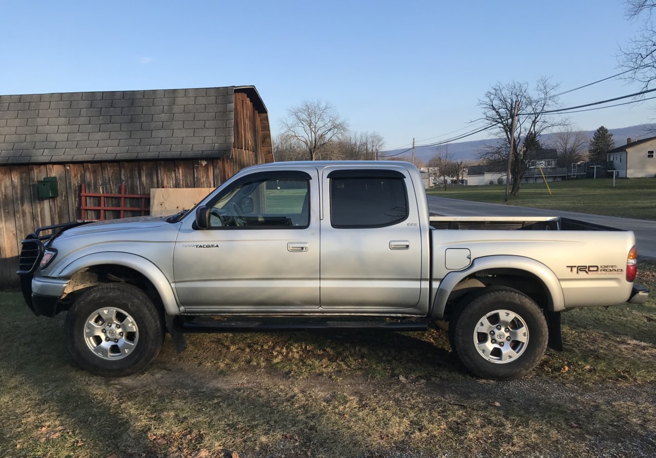

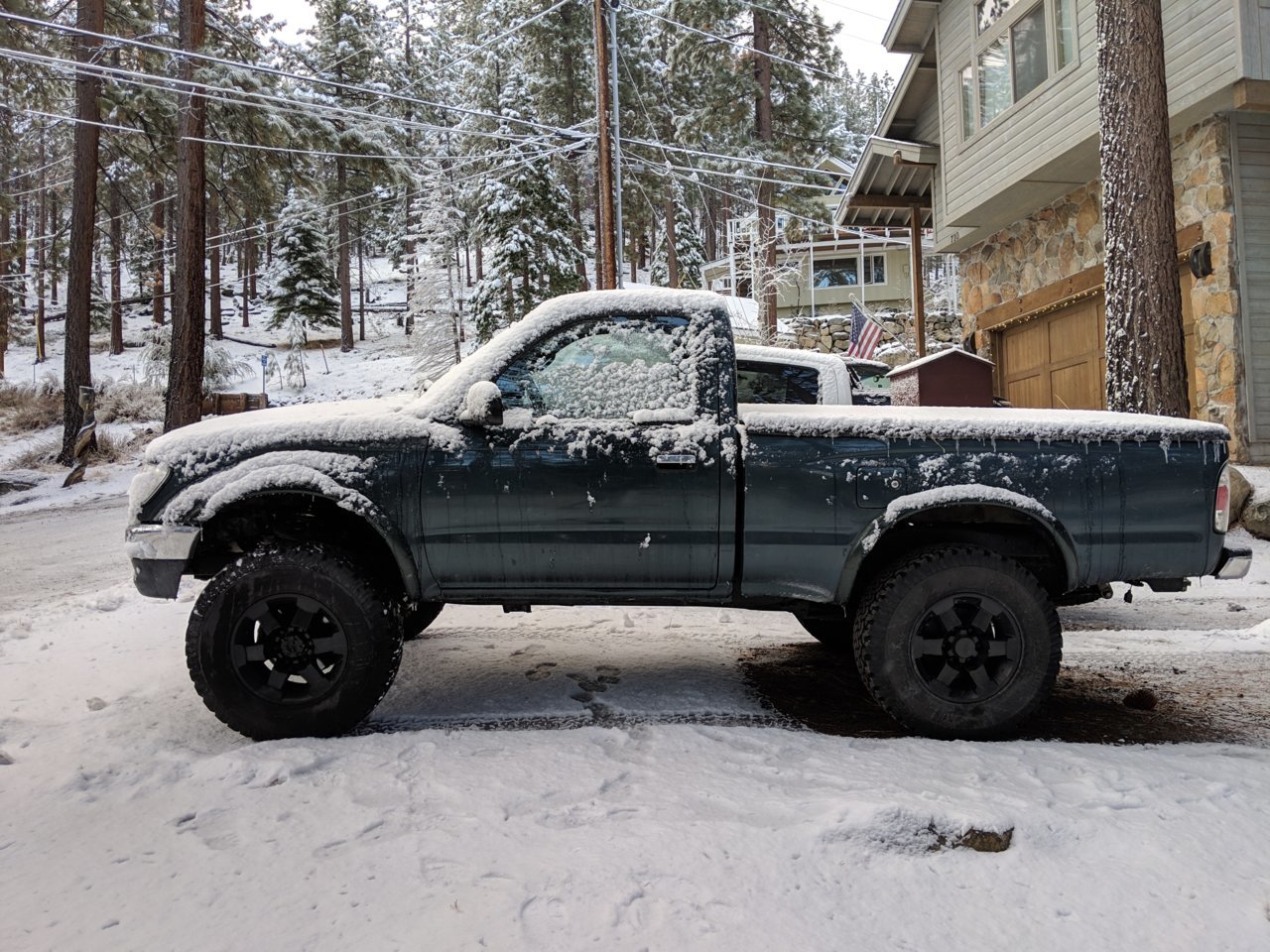

    Man, those are handsome wheels. It's like they were made for the lunar mist first gen. I appreciate the photos, solidified my decision to go ahead and swap them out

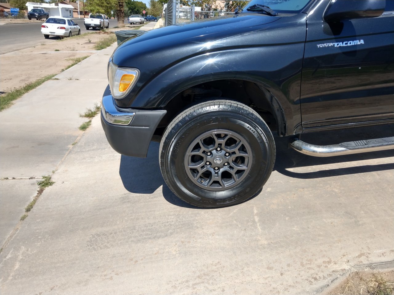

    2000 White Tacoma, 2.7, TRD, SR5, Extended Cab

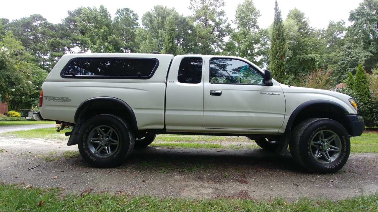

    OME lift kit 2", 3rd gen wheels, 265/70R17, 2nd gen header
    This is my new look on 265/70 R17. Backspacing for my OE wheels, 15 and these 2014 tacoma sport wheels have 18 backspacing. The tires sit a little closer to the inside of the well but no rub anywhere. They stick out about the same. I have a 2" lift provided by Old Man Emu.

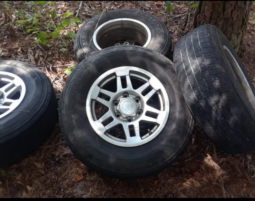

    2002 red Tacoma 4dr 4wd
    Leveling kit

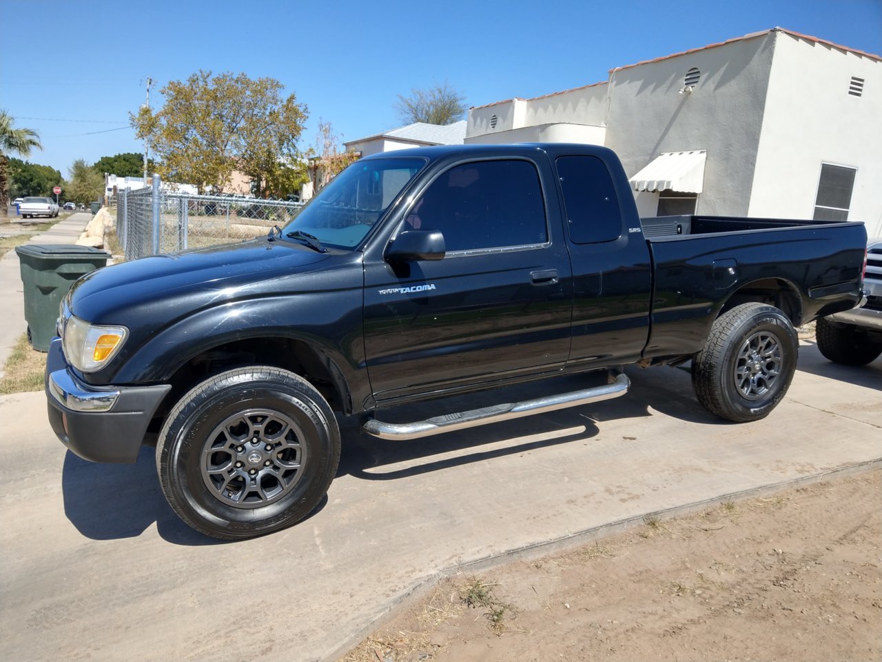

    Can anyone identify the year model for these wheels and tell me if they might fit on my 2002 Tacoma?...as I have an opportunity to purchase them at a resonable price. Thanks in advance.20181230_154222.jpg

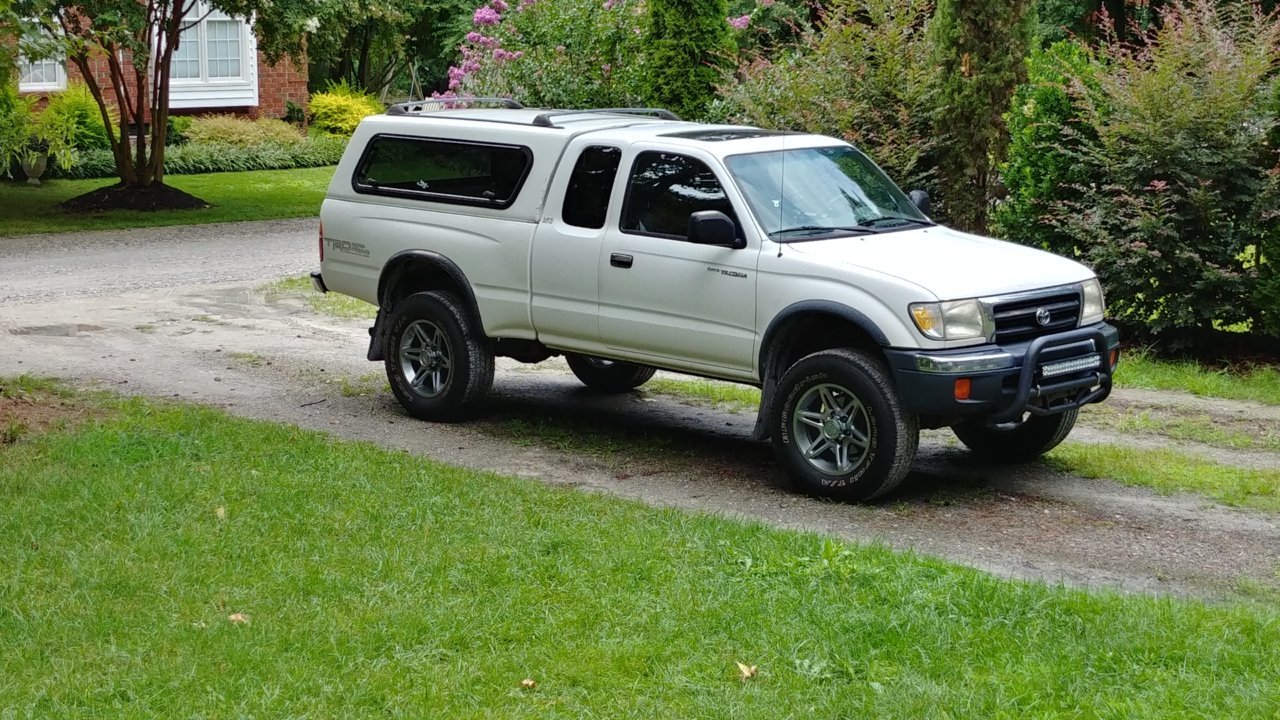

    ct
    2000 TACO PRX
    none really

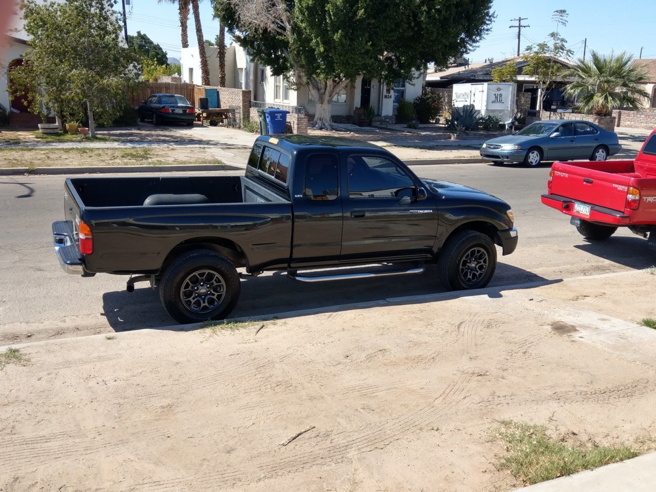

    Bolted up 2017 Tacoma offroads. No issue. Replaced the factory 15s and 31x10.5s. doesn't touch or rub .Used same lug nuts .IMAG0244.jpg IMAG0244.jpg IMAG0239.jpg

  5. Mar 16, 2019 at 3:04 PM
    #45
    disturbio
    disturbio Active Member
    Mar 14, 2019
    #286644
    27
    ct
    2000 TACO PRX
    none really
    Sorry 16 inch 245/75 . Pretty flush

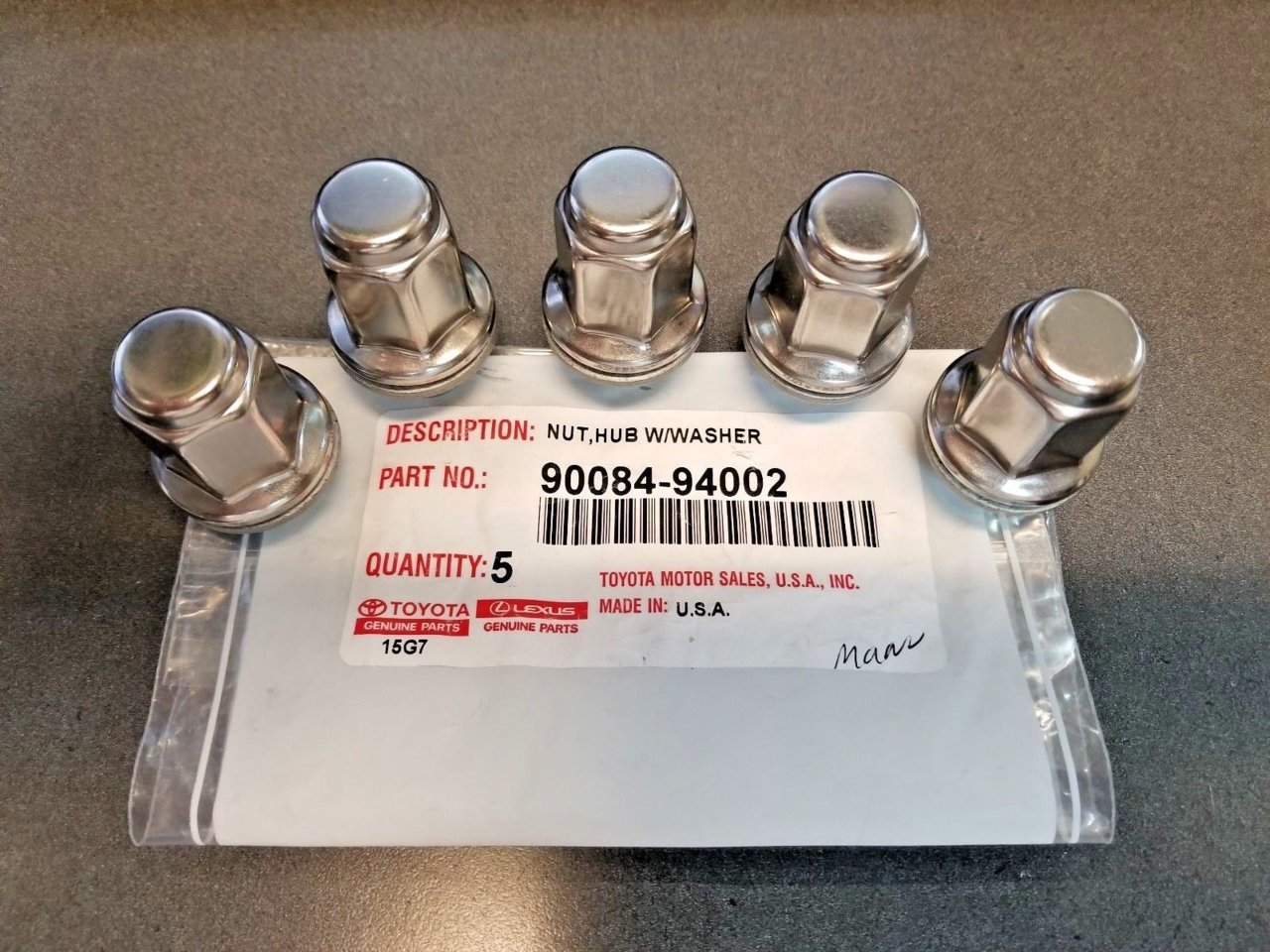

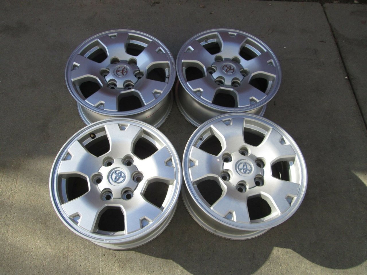

    If using Toyota alloys, recommend attached, not plated.
    Crank

    Do those look like a conical tip but with a flat area...like a top hat?

    Straight from Toyota parts bin. I am in TN most of year. Best Toyota dealer I have found thru the years for parts, is Toyota South, Richmond, KY. Ask for Jason,
    he will answer all questions, give you a great price on genuine Toyota parts, fast shipping, easy returns if needed. Parts: (859) 353-6885

    I agree. I paid 477.88 for the 4 Toyota alloys. Two from an individual with shipping, and two from Pro-Wheels, shipped. Correct NOS lug nuts.
