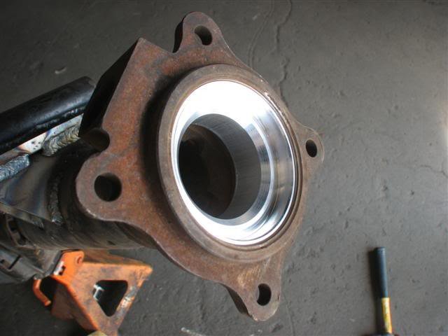

    Here ya go.
    TRD E-lockers use the ABS shafts, a non ABS shaft will not work in an E-locker. I don't know how to say it any simpler.
    The ABS provision on the TRD can be spotted from the outside. On the topside of the ABS rear, right next to the backing plate there will be a bulge where the ABS sensor would go. Usually this spot is machined flat, drilled for the sensor and capped with a plastic plug secured by 1 bolt. In rare cases it is just the rough steel and not machined/drilled.

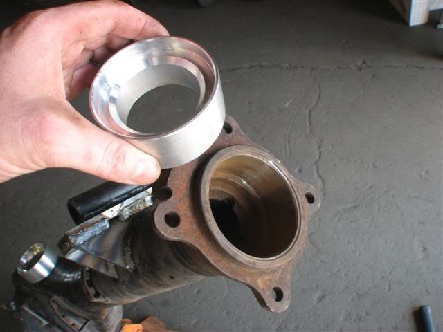

    So am I able to put a non abs seal in an abs housing and run the non abs axle? I dont see why not.

    No, go back and read post #16. Now look at your 2nd pic. It is hard to see but where the ABS seal sits, the bore of the tube necks down. That 1.5" or so of empty tube outboard of the seal has a diameter significantly greater than the O.D. of the seal.
    The O.D. of both seals is exactly the same and frankly, IIRC, they are the same seal. If not, they are real close.
    The adapter Marlin made was essentially a "reducing bushing" that pressed into the over sized ABS tube, reducing it to the appropriate diameter to accept the seal and locate it out at the end of the tube like your pic #1
    I don't think Marlin stocks this adapter or how much he gets for it but I am sure he would whip out a pair if that is the way you want to go. Give him a call.
