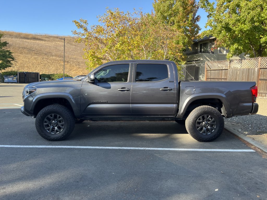

    It will most likely level it. Here’s an old pic i took while I had this lift. It was the 1/2” spacer up front and the trd pro/trial edition 1/2” block in the rear IMG_1442.jpg
    Ricardo13x[QUOTED] likes this.
