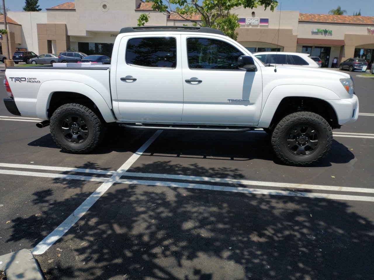

    Here is my 3” front and 1.5” rear bilstein lift on 265/75/16 BFGs.
    actual lift was more like 2.5” in the front though.
    if you don’t go off road very often then rough country is fine but I think you will likely be wanting to upgrade later so consider a higher quality of lift kit.
    At 3” up front you need new UCAs (in my opinion)
