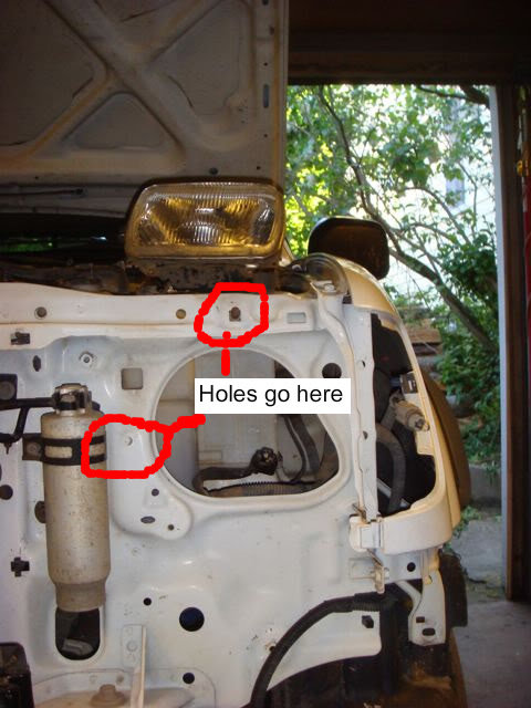

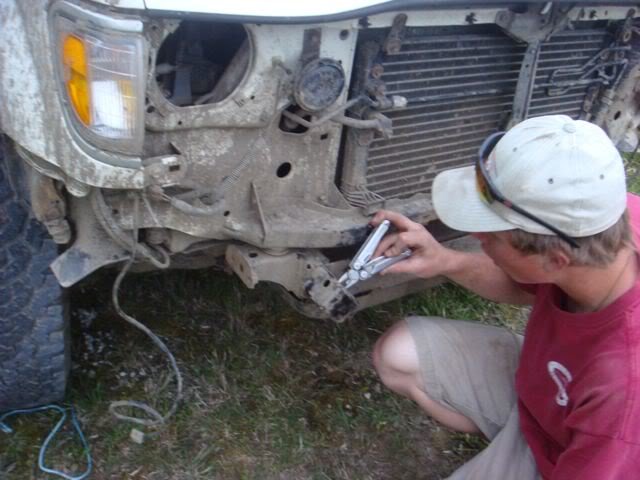

    Well hang on...
    If the 98-00 fronts have a circular hole behind the headlight like this:
    ...Then you can't do it easily.
    But if the hole is shaped more like this (ignore the writing and such):
    Then it should be relatively easy.
    I have all the parts except the hood and hood latch, and I would like to get rid of them. So if you want them, we can arrange something.
