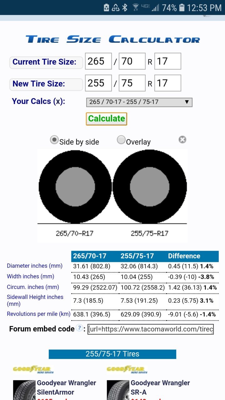

    Hey, I have a chance to get some nice tires but not sure if they will work. Anyone out there ever use this tire size? Thanks for the help.

    Yea should be fine. I'm running 265/70/17,

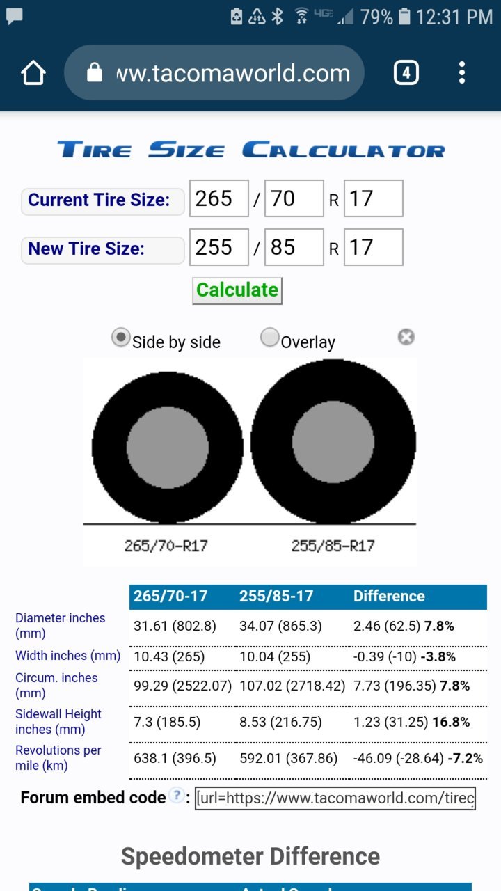

    If they are winters, may not be a bad idea. Skinny is better for winters - you see a lot of people going 255/85 for the pizza cutter look. However those are a lot smaller on the height, they may look worse than stock, if that matters to you.

    You do understand the difference in width between 255/285 is about 1” and the difference between 255/265 is about 1/4”.
    Not going to make a difference between 255/265 in handling unless you are turning at 90mph with weight. Does make a difference in MPGs though

    Not smaller height wise at all. They are 34's

    255/75/17 is a 32" slightly taller than stock

    255/85/17 is a 34" - youd need to trim and maybe lift/level

    Thanks for the Replies 255\ 75 r17 fit great :)
