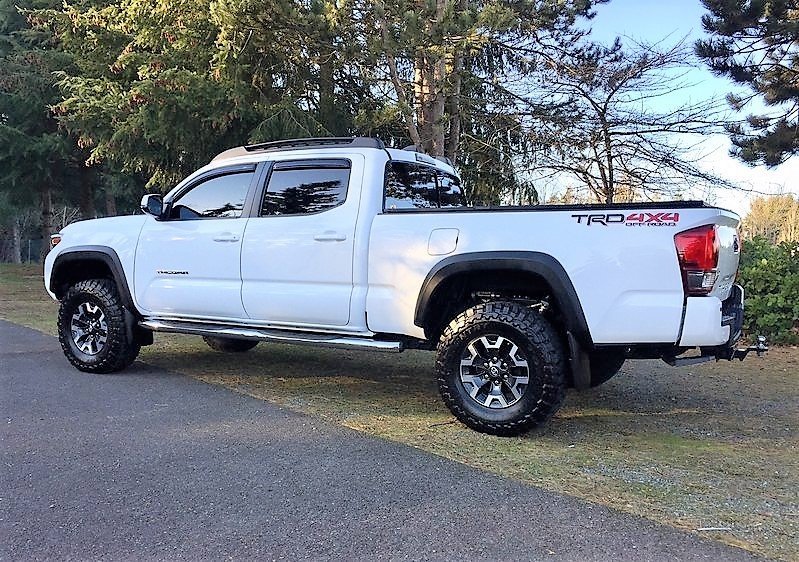

  11. Nov 28, 2020 at 3:00 PM
    Law950
    Law950 Well-Known Member
    Oct 29, 2016
    #200987
    161
    Ed
    2017 White Tacoma TRD Off Road
    Leveled with Icon Stage-3 suspension Toyo Open Country MT's, (LT265/75/R16) TRD Performance Exhaust TRD performance Air Intake
    Yes, it will fit. I run 265/75/16 Toyo Open Country M/T's and have this tire & size under my truck as my spare...it fits perfectly with no issues at all. :thumbsup:
