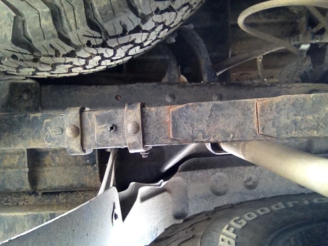

    Anybody with pics of a 285/75 16 tucked up back there?

    whose got pics of a 285 stuffed up there?

    digitaLbraVo
    digitaLbraVo Derka Derka
    Sep 6, 2012
    #86398
    7,514
    Covered in stickers and chrome stick-ons for extra horse torques and foot powers. Icon sticker gets me tons of travel, dozens of milimeters.
    It looks goofy 'cause it's so wide it kinda hangs down under the trailer hitch. No pic of it there, just here...
