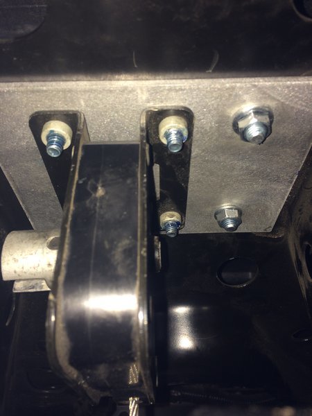

    Purchased a spare tire from Americas tire today- 285 75 16 Pathfinder. Looks to be a decent tire and he'll it's just a spare. Most important... It fits without much drama. I hardly bent the locating tabs and it helps push the tire up against the hitch. I still have to move the tire lift forward but I want to add some aluminum plates to beef up the rearward most holes has they are right against some of the factory cutouts. Will post photos after plating and hoist are installed. Thanks Crom for your input!

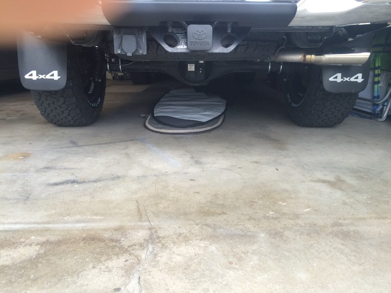

    image.jpg image.jpg Here's the pics after hoist area was plated with1/8" aluminum- above and below. Tire doesn't hang down too much at all and it sits almost completely level. The forward most bold holes, where the hoist was at, were utilized for bolting the aluminum plates to the carrier frame. Pretty easy to do
