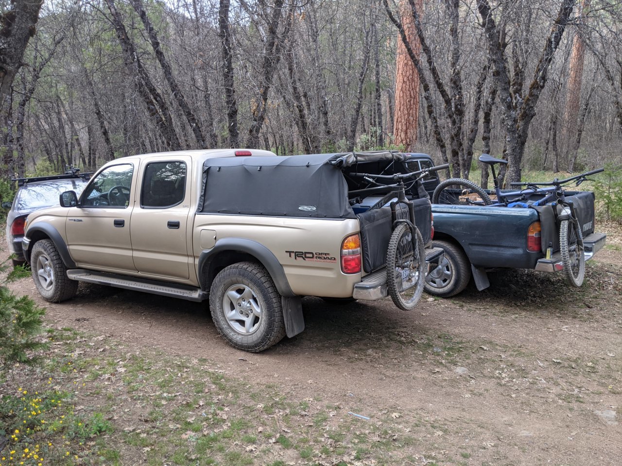

    I have a short bed, but I believe the difference is the same: the 1st gen topper is about 3" taller than the 2nd gen. Here's my first gen with second gen topper. For the price I payed, I'm happy. If I bought one brand new, I'd get the right one. Hope that helps

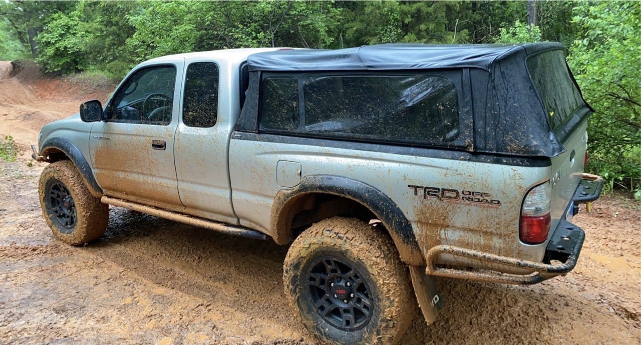

    Mine is off a 2nd Gen. I had to modify the back bar for the rear window. But it fits decent. Only downside is the window against the cab is a little low.

    Thank you, when you say “modify”, big job or easy job? Now I’m reading on the softopper site, 2001 to 2003 is different than pre 2001, and I can’t even find any new one for 2000 models, so I’m thinking of modifying, lol

    Just heated up the tab, and hammered it down.
