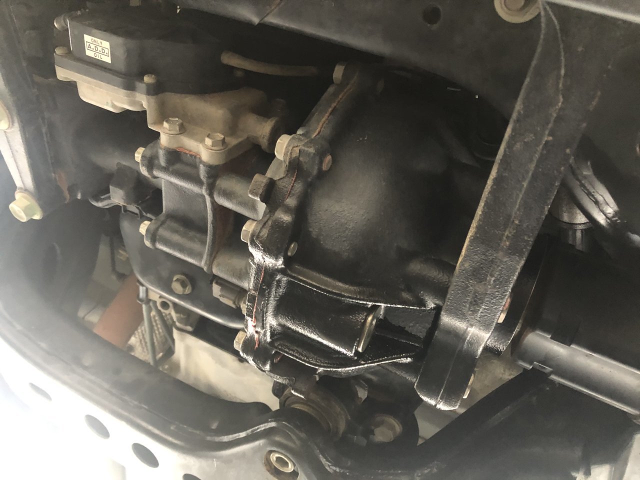

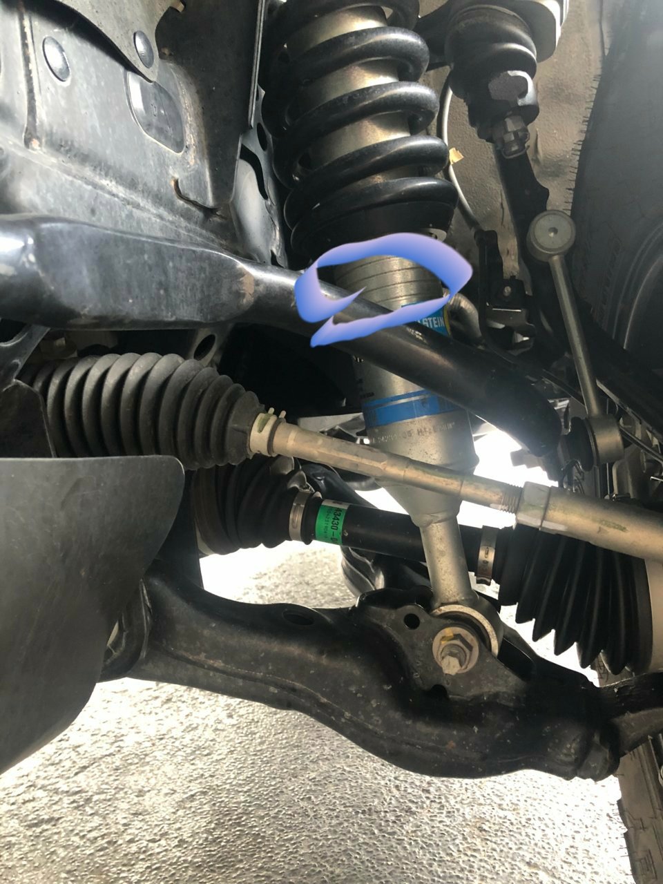

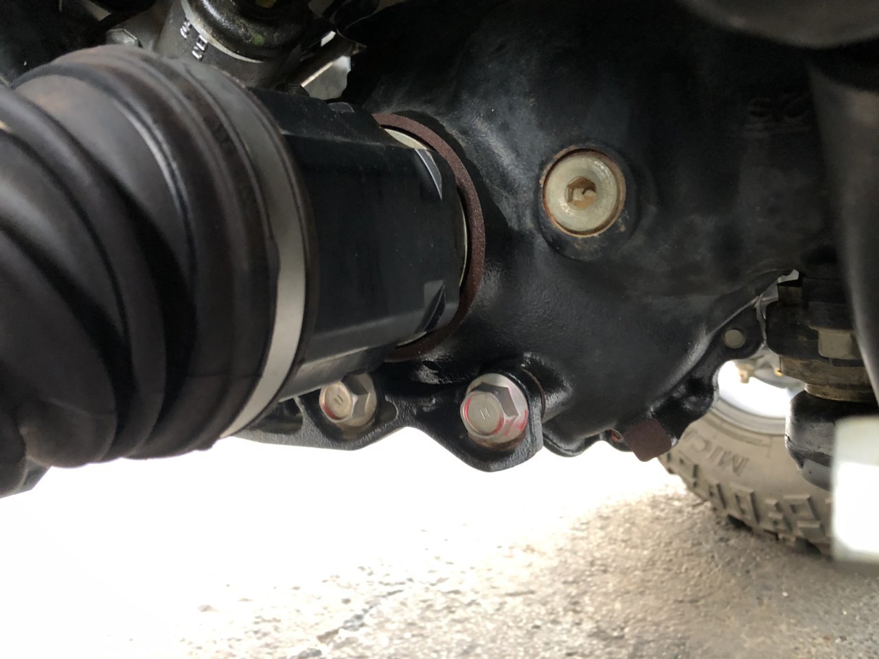

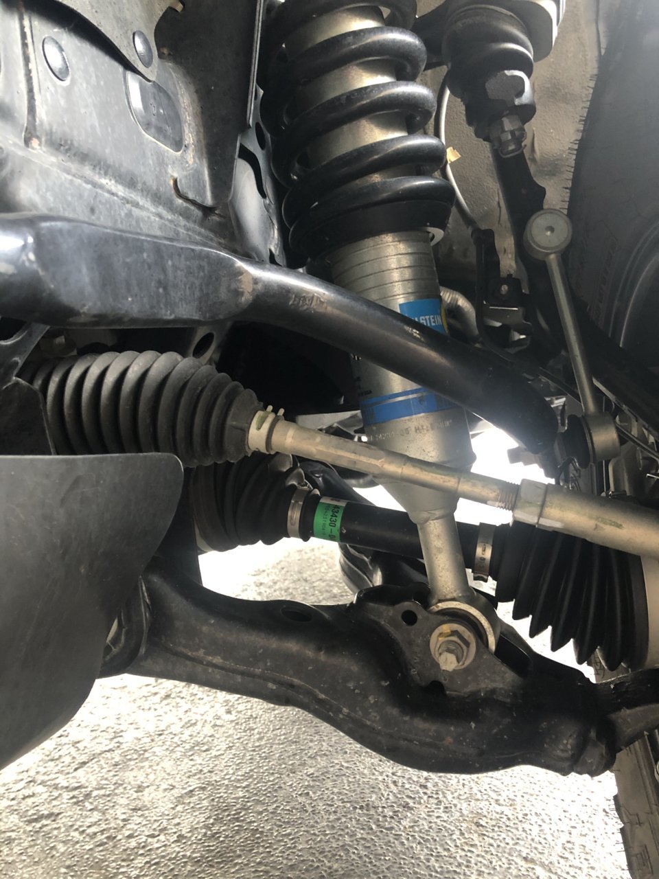

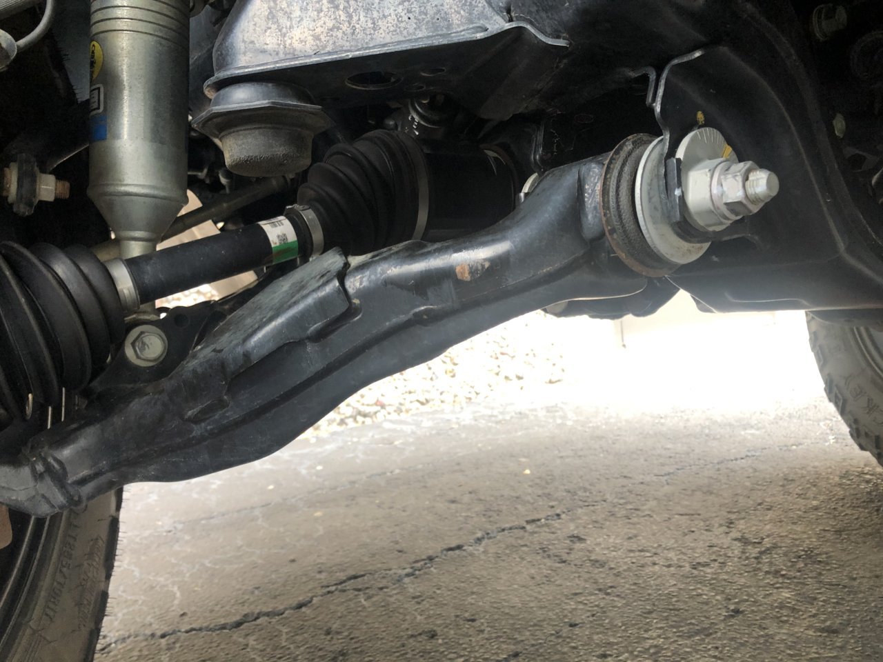

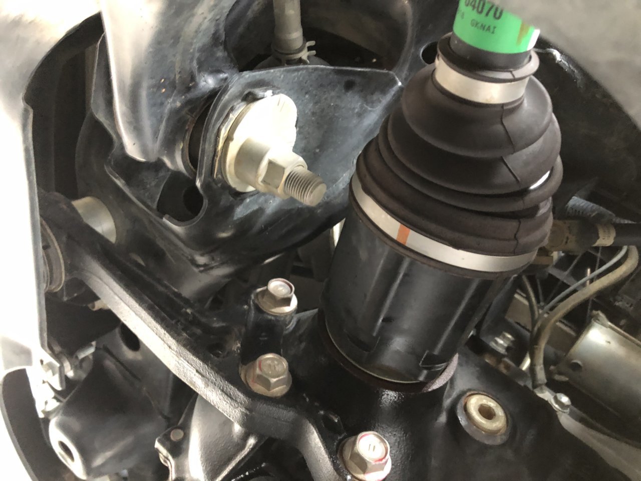

    it was 3” and that’s was the statement from the dealer could be during installation also they offer me I can bring it back so they can show me but it’s useless coz I don know what I’m looking at I will try to contact again Duggys Garage if they can go with me so we can end up this not our fault it’s not us,we didn’t do that statement
    Appreciate all you time
    Here are some pictures
  11. Oct 14, 2020 at 3:58 PM
    SpeySquatch
    SpeySquatch Function over Form
    Mar 6, 2018
    #246516
    7,366
    2016 TRD OR DCSB
    C4Fab LoPro, BAMF Sliders, Ext ADS 2.5’s, 4.88's, OVTune (OG to KDMax)
    Yikes! Those angles are nasty bro. Drop it down to 2” max. Function over form my friend
  12. Oct 14, 2020 at 3:59 PM
    NorNev
    NorNev Phone? Call someone who gives a shit.
    Jan 1, 2020
    #314807
    479
    Dave
    39° 31′ 6″ N, 119° 59′ 19″ W
    KDMAX Tuned 17 2•2X2•2 Hood Scoop
    A Few
    Looks like the seal. Clean off all the fluid with a solvent and re inspect

    Is that LCA broken?:eek:
  14. Oct 14, 2020 at 4:04 PM
    tcjacado
    tcjacado Well-Known Member
    Aug 29, 2016
    #195947
    41,570
    These rings are what hold the spring perch.
    Shocks need to com off and be lowered at least 2 clips I would say to bring those angles to decent.20201014_160248.jpg

    It does kinda look like that from the angle of the pic but no he's good in that dept lol

  18. Oct 14, 2020 at 4:12 PM
    #18
    Aardvark13
    Aardvark13 Sultan of Squeeze, Wizzard of Slide
    Mar 23, 2018
    #248164
    1,275
    Byl
    Knoxville
    2014 DCSB OR
    Aardvark4x4 Built for Go
    If you like the height of your lift you have, a differential drop kit is an easy solution to level out those cv axles a bit. Changing the seal is pretty easy, i think the seal is about $25 from the dealership.
