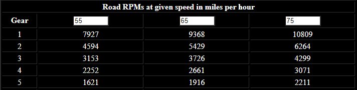

    My $0.02.
    I would love to have 4.30, but with my truck I would need to also purchase a new carrier for those gears to fit, adding cost. I'm not positive if that is only due to me having the TRD OR with the Locker, or not. So you might be OK, depending on your current differentials.
    I also doubt you want to go any further than 4.30 if you don't plan on putting on larger tires or added weight. My truck is a fat pig (over 6000lbs) running on OEM sized tires and I regularly tow over 4000lbs on the stock 3.73, and it gets the job done. I just keep going back and forth between 4.30 and 4.56 for my situation.

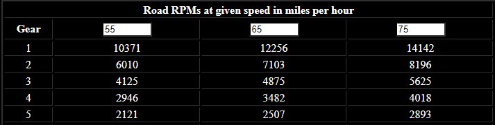

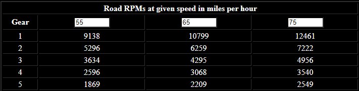

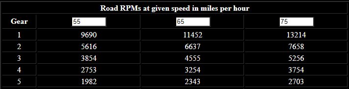

    I pulled these screengrabs below from the grimm jeeper calculator. You can see the different RPMs you'd be pulling at 55/65/75mph in each gear. And remember, as mentioned above, you should never tow in 5th, but instead shift into 4th to keep it from kicking into and out of Overdrive. Going 4.56 or 4.88 would just hurt your mileage excessively when you aren't towing.
    3.73
    4.30
    4.56
    4.88
