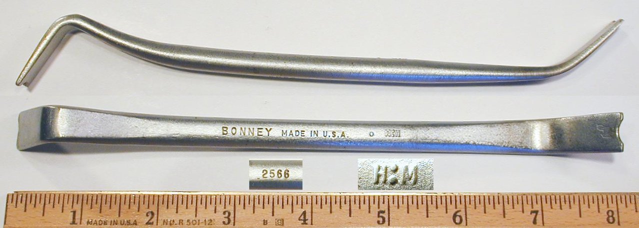

    I also use a proper brake spoon instead of a shitty screwdriver.
