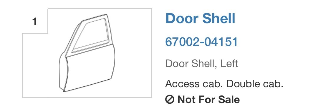

    Pretty much what it says will a dual cab driver door fit extended cab?

    Between a Double Cab and Access Cab? Yes:
