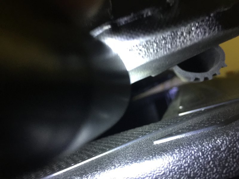

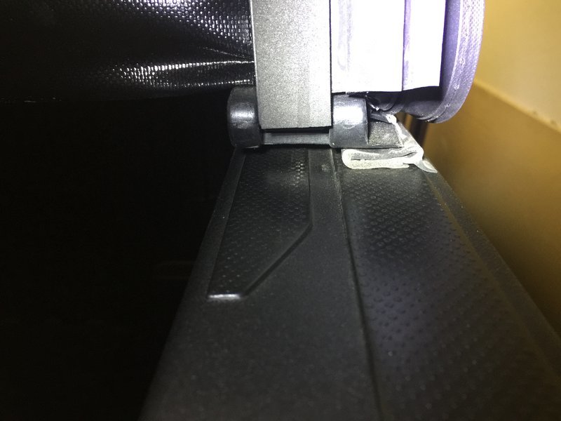

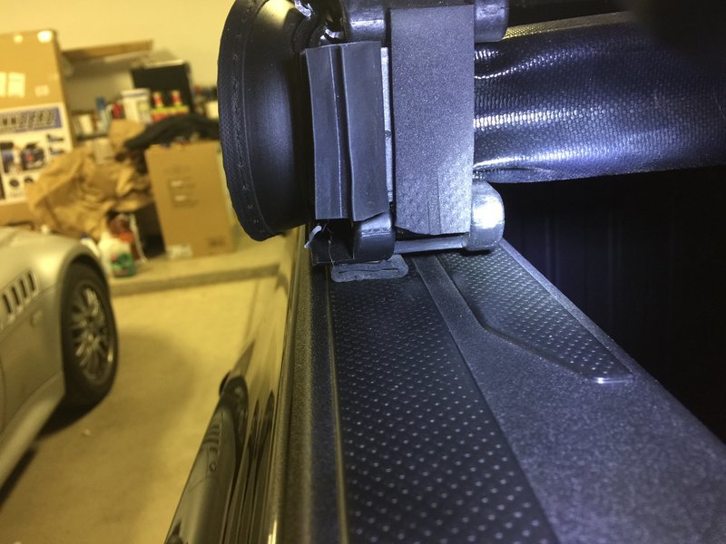

    I just traded in my 2010 for a 3rd Gen. I purchased a tonno pro and used it once on the second gen.
    I sat the 42-501 on my 17. It seems to fit, but the front rail of the bed is my only question mark for water tightness.
    The clamp system seem to be to long with the current plastic spacers on the stems. It looks like the rails are higher on the 3rd gen.
    Removing one of the spacers will likely do the trick.
    I really don't care about it being totally watertight as I live in AZ and the purpose of the purchase for the 2nd gen was to hide my stuff while I was traveling.
    Since I plan to give it a try with my 3rd gen, I will let you know more about the sealing ability once I put it on and clamp it into place.
    Update:
    Here are some pictures with it sitting on the bed, uninstalled. The first view is the head rail near the cab from the side so you can see it is sitting about half way on the rail.
    The next two are the side rails and the last is the tail gate.
    Judge for yourself.

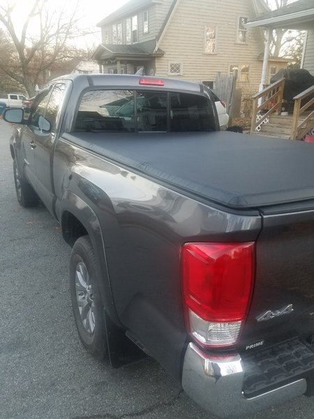

    I have a 2nd on my 3rd. Measurements were exactly the same. The only difference was I have that square tube across the front of the bed and there is a small gap on each end. videos of installing a 16 tonneau cover showed them taking that tube off and putting the provided gasket in the space and then reinstalling tube. My 2nd gen cover came with 2 long strips of that material so I cut 2 squares the size of the tube and put them in. I have had no leaks or anything and I saved a bunch of money.
