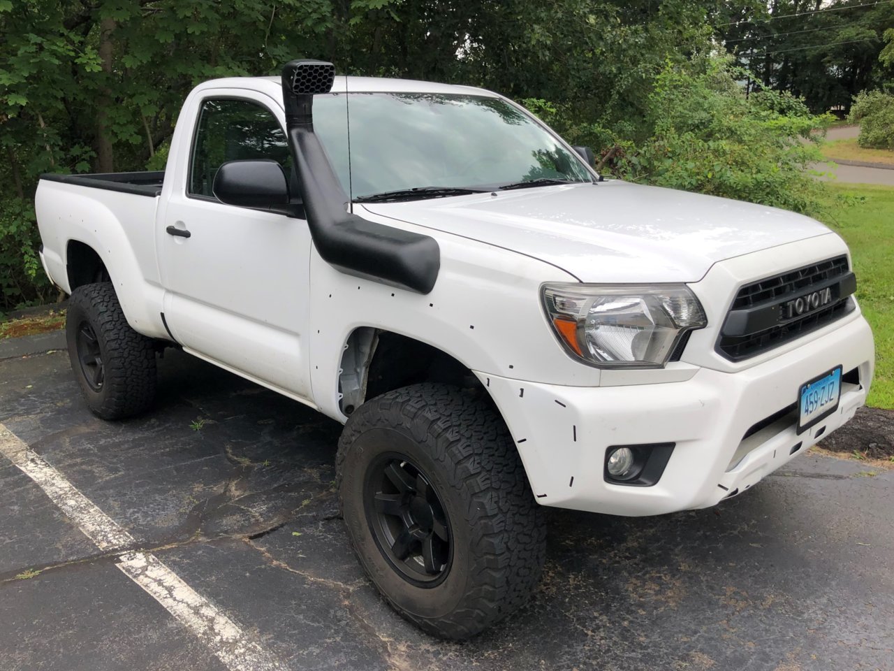

    On Facebook I saw a guy with a snorkel on his 2nd gen regular cab but everything I searched seems to only fit a 3rd gen v6. Reason I want one is i want the clean air as I noticed my filter gets dirty on dirt roads (duh) plus I think it looks cool lol

    Did you have to mod it at all to fit (besides cutting the hole)? Do you have any pics

    I have a Dobinson's on my 2012 regular cab. It fit's but not very well (the snorkel contour doesn't match the fender).
    The ARB Safari snorkel fits better but it's also a lot more money.

    Looks good!
