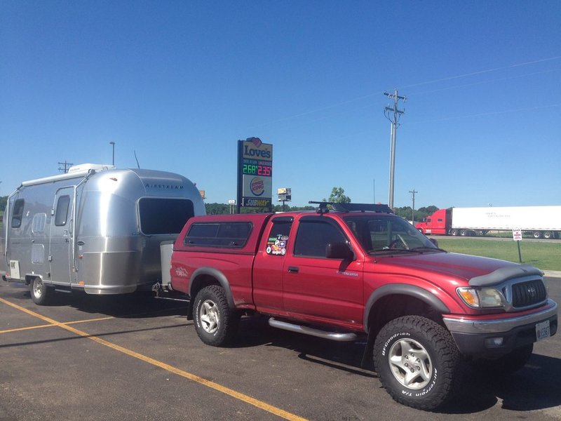

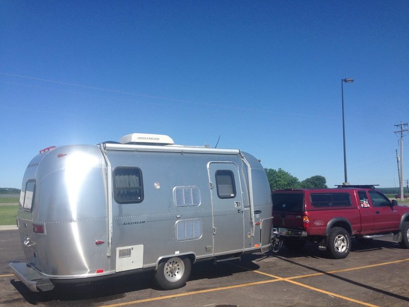

    I understand that there are limits to towing whether I have a Supercharger or not and the 1st gens are not the best vehicles for towing a travel trailer. However, my truck tows my 2004 Airstream Bambi okay but obviously it's not perfect. 65 mph on the highway and a lot of down shifting to 4th gear.
    My Bambi weighs 3700 lbs dry. I weighed my truck and trailer empty and then loaded before I drove from North Carolina to Wyoming and the total loaded weight being towed and hauled was 4400 lbs. With a side trip to Utah I did around 2,700 miles without a problem. I understand this is pushing the limits of what a 1st gen Tacoma can tow so I did the following upgrades before hitting the road:
    1) Electric brake.
    2) Weight distributing hitch.
    3) BF Goodrich Load Range E tires.
    So my questions are:
    Will a SC help make up for the lack of power while still staying within the towing limits and would it be worth the $$$$$$? My truck also has 145,000 trouble free miles on it so monkeying with the engine makes me nervous.
    Or, should I think about getting a 2nd gen with more towing capability or a diesel?
    Thanks.

    badass Airstream:thumbsup:
