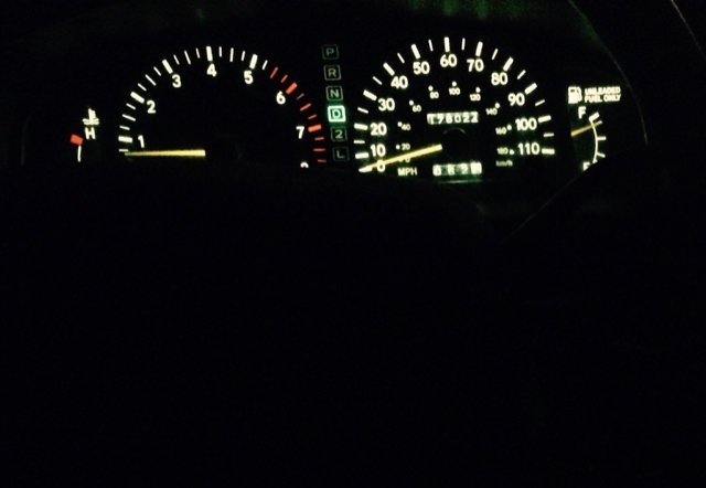

    96 Tacoma LX 4 banger
    Manual tranny tach clusters are more common than auto. In my 96 is the super rare mechanical speedo cluster with tach for a 4cyl auto. Make sure when you buy a cluster that you get one that came out of a truck with the same setup as yours. A V6 cluster will read differently if put on a 4cyl truckc18b8a82dc42ee17751bb9d72c2da82f_bad182723b7d6c77ddc73ba21304cc3122bde5fd.jpg
