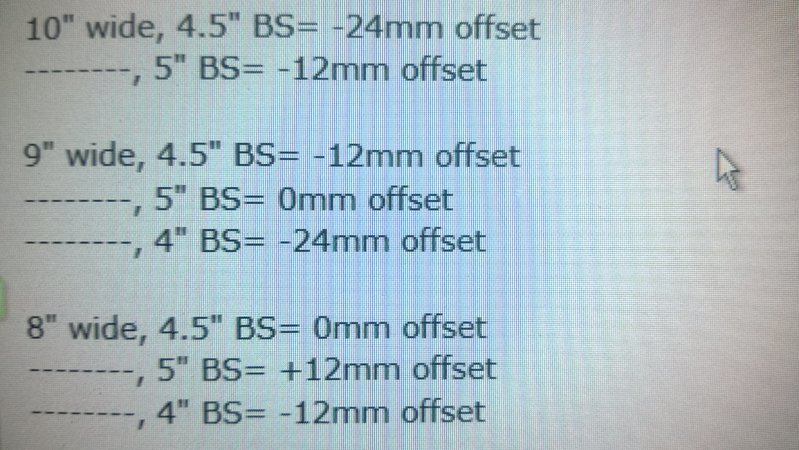

    Tire rub is all about rim spacing. If you're on stock rims, you may need wheel spacers to avoid rubbing. If you have, or plan on aftermarket rims, use this formula to get between 4.5" and 4" back spacing.WP_20160523_001.jpg WP_20160523_001.jpg

    You say almost 32's. What size? What width if they are skinny or wide makes a huge difference. Wheel backspace also plays into this

    Well my tires currently are pretty wide, but I will be installing BFG KO2's and they will be 265/70/R17, which is 31.5 inches in height. I know they won't rub fenders flares.

    I and many others have run that size on stock suspension with no rubbing

    Cool, so the new shocks and UCA won't change that I assume. Thanks
