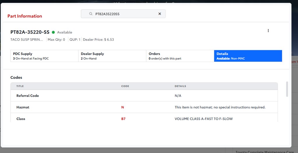

    Will buy PT82A-35220-SS 1/2" axle lift blocks. Let m know how much thanks so much!

    I'm unable to source them locally they won't release it because I don't have a TRD pro

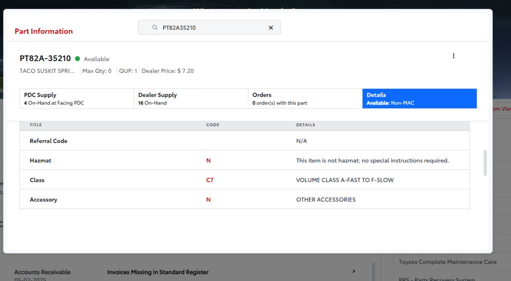

    Does anyone have the part number for the 1-in OEM lift block? I can't seem to find it

    PT82A-35210 is the 1in block.
    ponts[OP] likes this.
