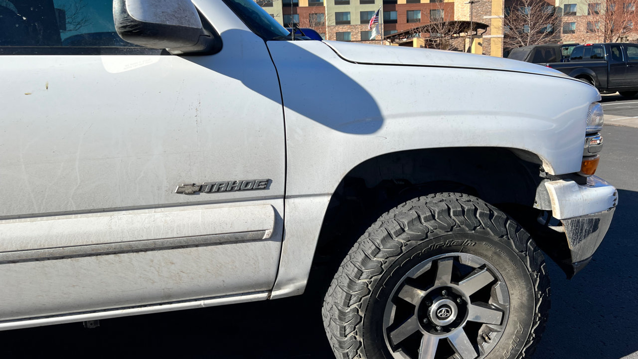

    not my truck!, but you can go toyota on chevy apparently.... Just make sure you use the wrong lug nuts too...
