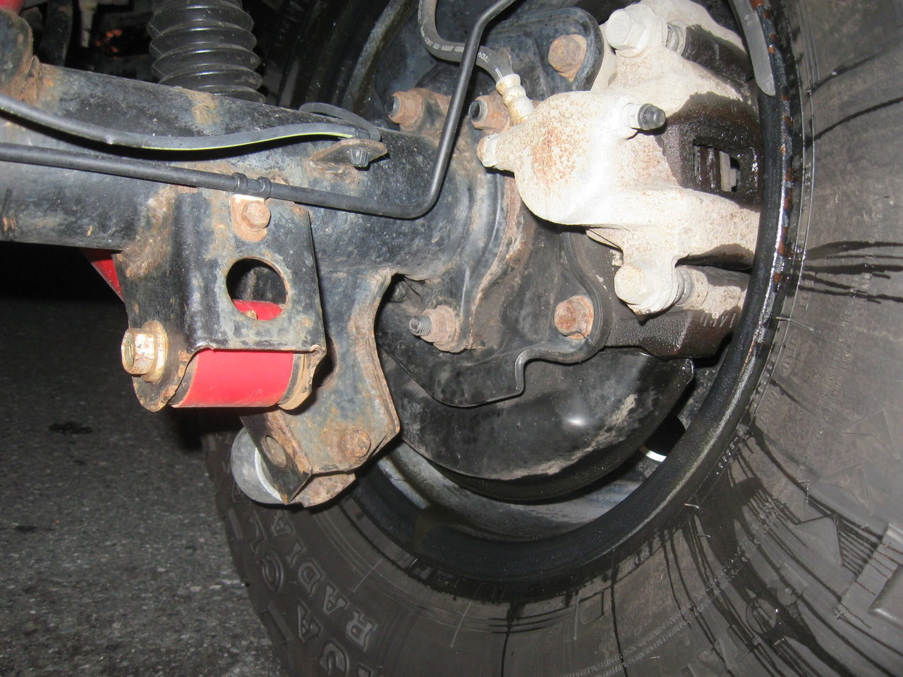

    Yes, I realize the drums already do a perfectly good job. I just prefer discs.
    With that said, I imagine it's a similar setup already. Any confirmation?

    The lug patter is the same so yes the discs themselves would fit. The problem is you would need to remove the drum brakes and the backing plates and anythin to do with the drum brake system. Then fabricate brackets on the axle tubes for the calipers to mount too. Then you'd need a different master cylinder since the calipers require more fluid than wheel cylinders. Plus there's a few little odds and ends I'm forgetting.

    A new master cylinder isn't necessary, but perhaps the stock FJ rear end could be compared to the stock Toyota rear end to determine exactly what is necessary there.

    The '03+ 4Runners also had rear disk. I am not sure what is different between the FJ & 4R.
    I haven't measured or looked in-depth of this. I think that the Rear brake/axle mounts are the same between the drums & disk on the axle; they look to have the same 4 bolt mounts on the axle tube.

    I like the idea. The FJ's have a lot more going on in terms of suspension and linkage, but I wonder if everything else underneath is the same.
    Maybe the two ways of going about is it to get a stock FJ rear, remove all the linkage and suspension supports and weald the appropriate Tacoma ones.
    Or, get the rear axel components of the FJ and see if they bolt up to the Taco or weld the right disk mounts.
