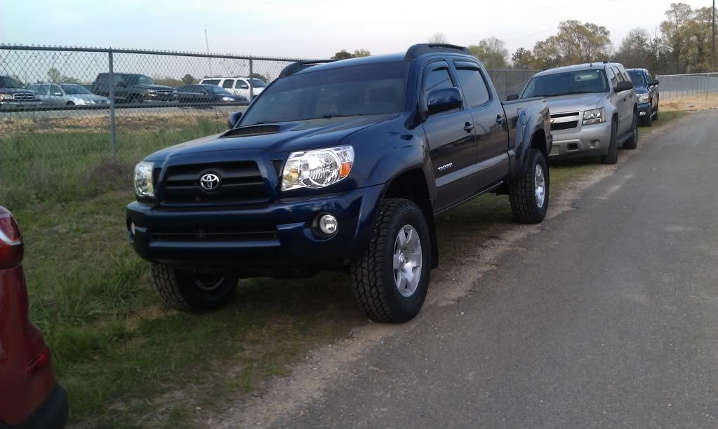

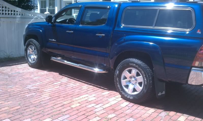

    Are these the FJ wheels you're looking at?
    If so, they will bolt right up with no problems at all. They will even use the stock lugs and TPMS.
    My tires are also the 265/70R17's.

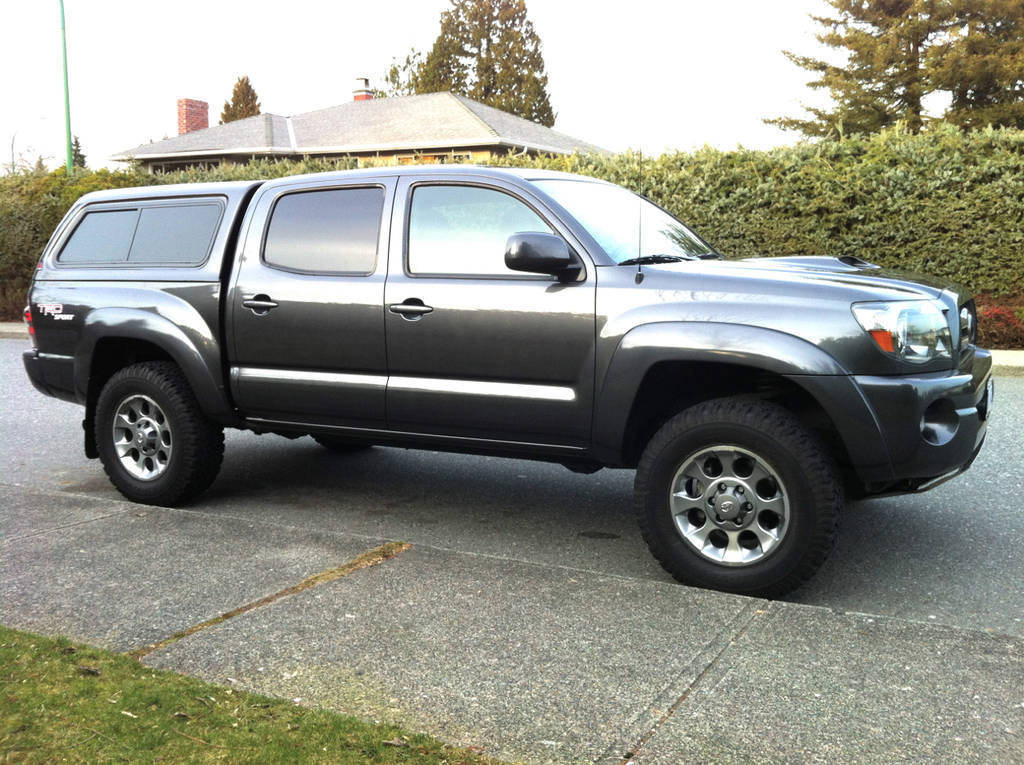

    BFG A/T KO 265/70/17, '11 FJ wheels, 5100's all four corners, Eibach springs, 1/4" Taco lean spacer, Leer 100XR, WeatherTech liners, trimmed mud flaps and I farted in it.
    they fit...265/70/17's..old pics, front husky flaps are on now and zero rubbing issues

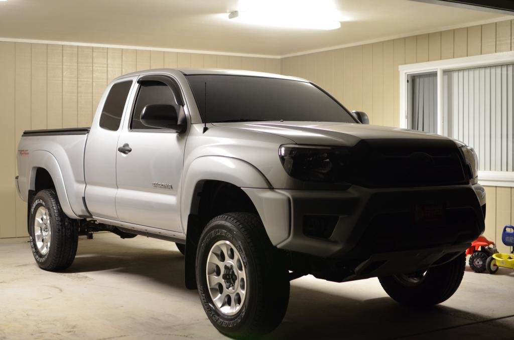

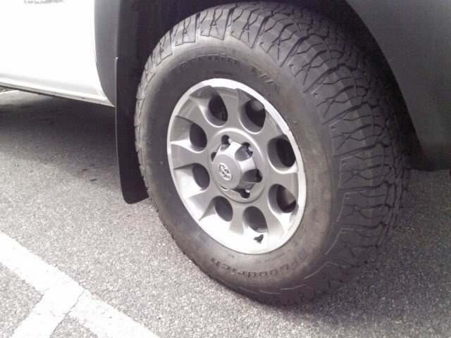

    my truck...13 4runner trail wheels...
    5fb55f21c22dad8cdb2c6c47bae85fff_zpse03d_05715abe8d5ade82d78c45b2c5b3689fb12dabcb.jpg

    Really like the look! I am considering the same wheels if they are the same as FJ wheels. Is the truck lifted? What size tires? How does it handle with the wheels out slightly farther?
    Thanks
    Tom
  20. Mar 5, 2013 at 6:51 PM
    #20
    Xer0 SiN
    Xer0 SiN Well-Known Member
    Mar 16, 2010
    #33334
    790
    Hilo, HI
    13 TRD OR 4wd, 6spd
    this and that...
    sky: thanks a lot. i believe the 4runner trails wheels is the same as the fjc wheels, with the exception of wheel color. i think the wheel color is slightly darker. dont quote me on that though LOL. i am lifted. i have icon extended travel coilovers and icon 2.5 smooth body rears with toytec 2" aal. im lifted slightly over 3" and have no rubbing whatsoever and i still have my flaps. my tire size is 265/70/17. if youre in the market for trail rims, i would get them. they turn a lot of heads since these rims on a tacoma is pretty rare, atleast where im from :) .
