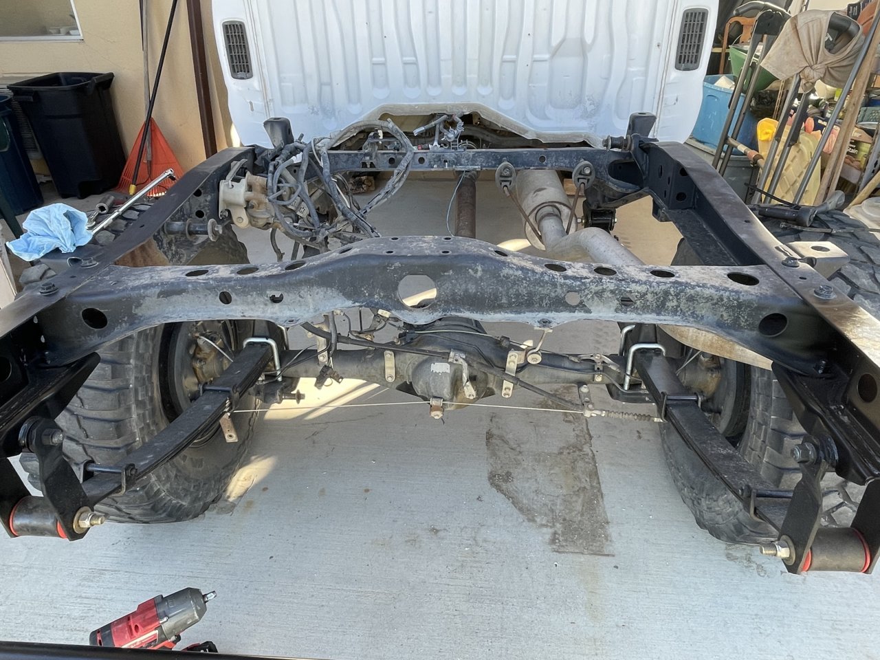

    What’s up everyone, on my 03 ext cab long bed I am cleaning up some rust and painting the frame under the bed. There is quite a bit of rust next to and a bit behind the rear crossmember that the spare tire carrier attaches to.
    I want to remove this crossmember treat the inside of the frame rail well, if I remove this crossmember is the frame have a possibility of twisting or spreading? If it twists or spreads but I can get the crossmember back in and bolted down is that an issue that will bite me in the ass later on?

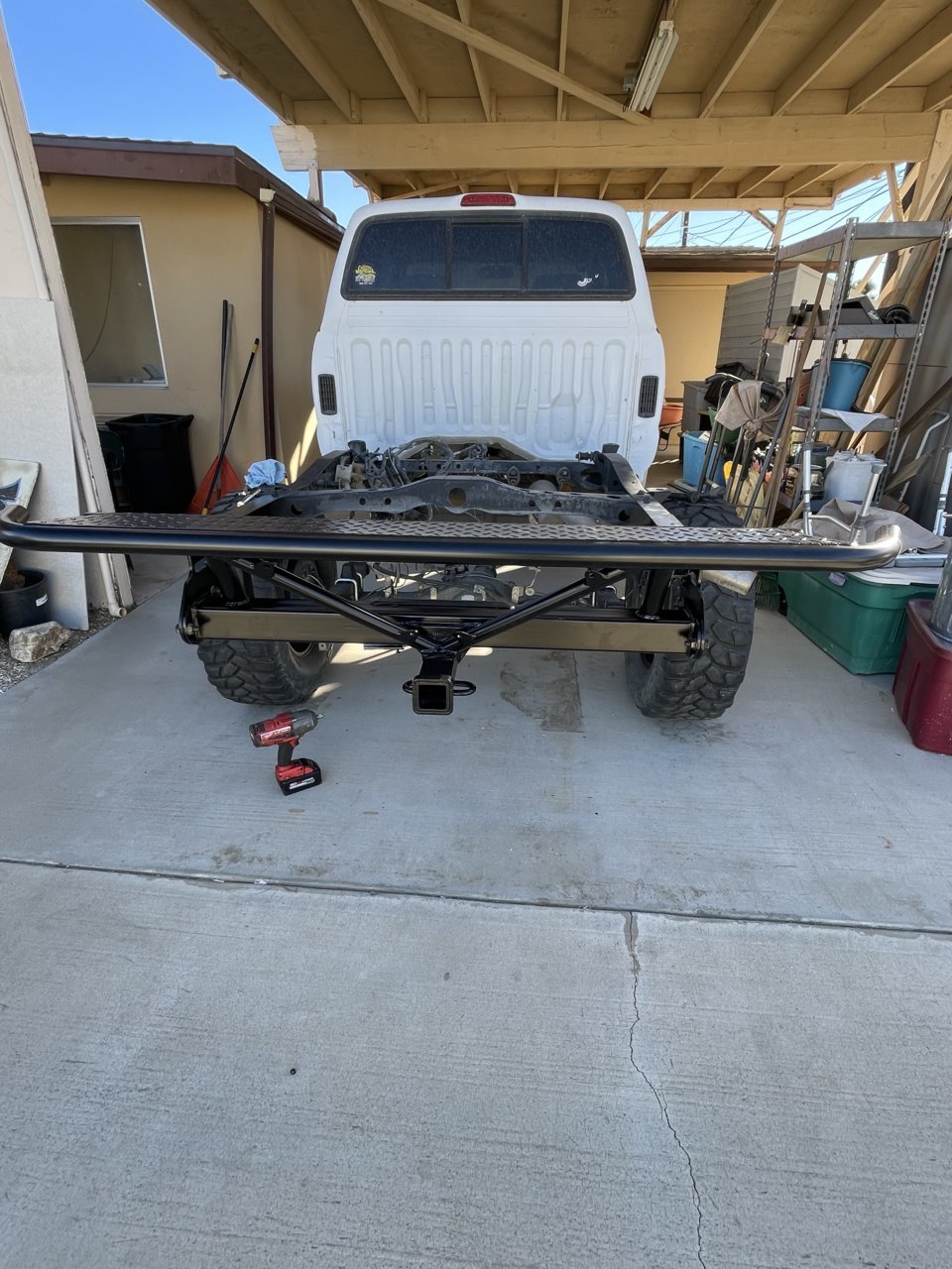

    my rear bumper will stay installed while this crossmember comes out, but my bumper is just a tube bumper built off the OEM towing package trailer hitch. Here’s what I’m working with:
    Crossmember I want to remove briefly to paintC680DC67-7047-46B2-8378-7B52EE1B23A8.jpg
    Rear bumper built off towing package hitch crossmember 91E843DF-84F1-49D7-8EC6-FDFC1FB82980.jpg

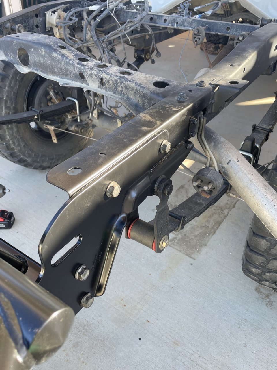

    How the bumper is bolted to frame. There’s two more bolts on the bottom of the inside of the frame rail6F2DE953-CBDC-4CA2-966E-48560B2F7757.jpg

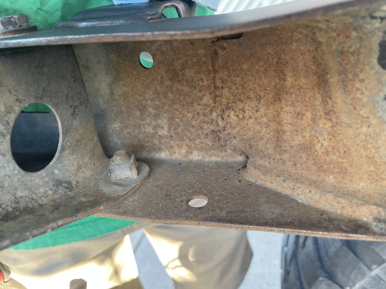

    And the rusty spot I’m looking to treat, I guess I don’t HAVE to take the cross member out but I’d like to do a thorough job.B8E28E6C-7E53-4741-989A-93268FE2688F.jpgthanks for reading and for any advice you may have for me!

    is that a bed mount on the outside of the main rail (over the exhaust)? Matching one on the other side?
    A piece of super strut (electrical mounting channel)
    or even 2x4 bolted to those should make a good temp fixture. [​IMG]
    I don't think the frame is going anywhere when you pull that out, since you'll not be subjecting the vehicle to any forces, but if it makes you feel better.....

    Just "c" clamp a 2 x 4 across the top of the frame.
    Measure the width and mark the 2 x 4 for future verification. Accidents can happen.
