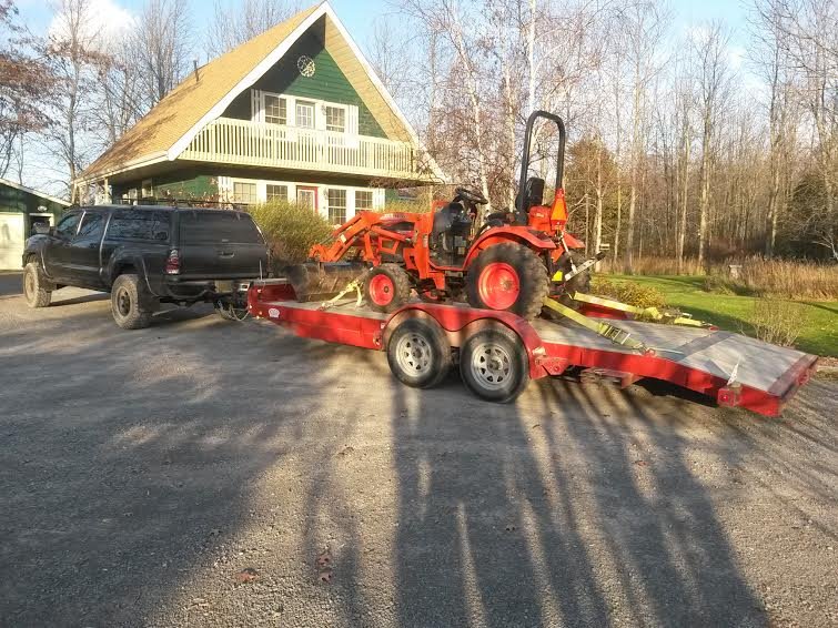

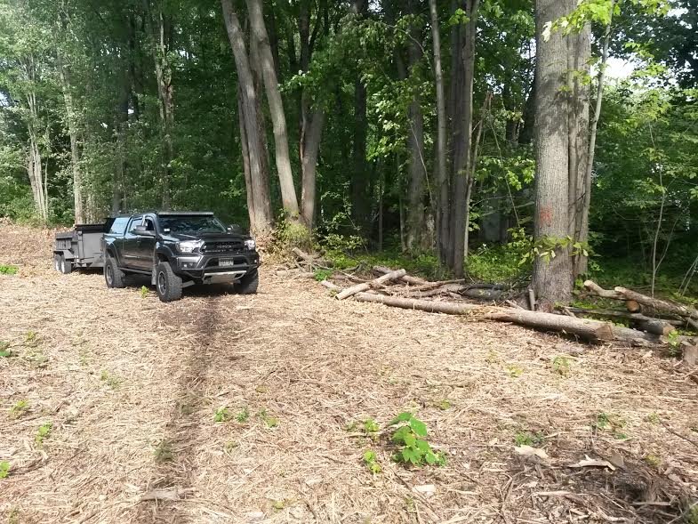

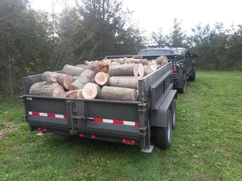

    Yes
    Check my build for suspension set up.
