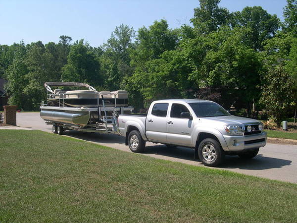

    I now have a 2011 Tacoma DCSB OR with an Automatic. The Picture is my 06, same truck only it was a 6-speed.
    Boats a 24' bennington with a 115 Yamaha 4-stroke. It's a load and the gas mileage drops off but it pulls and stops just fine. Trailer has surge brakes on both axles.
