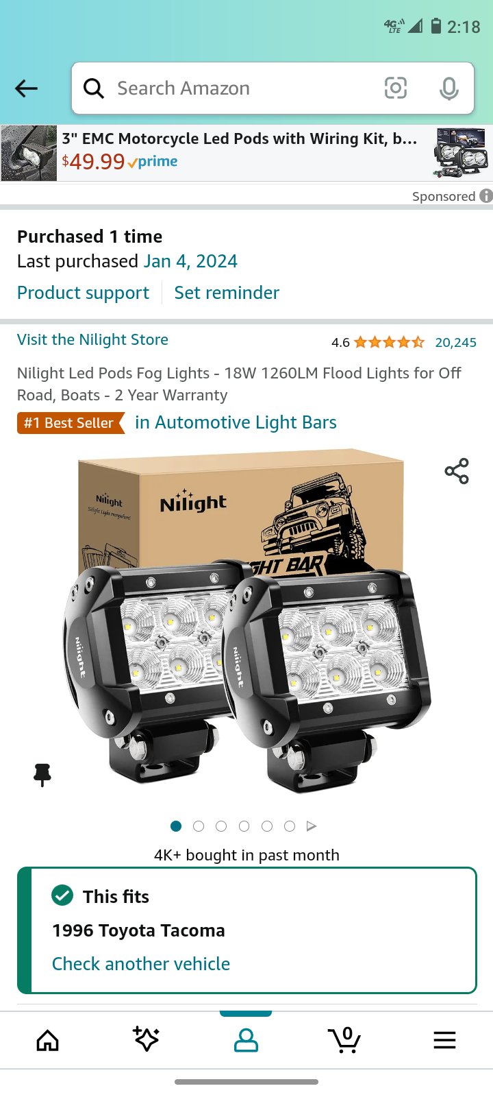

    I can't see Jack at night when I back up due to tinted shell window. Finally installing LED lights under my bumper and just splicing the positive wire to my back up bulbs and grounding it to the bumper.
    But will the extra power drain blow my fuse?

    LEDS use much less voltage/power so no will not pop fuse
    if you wire those^^^ (correctly) you will have no issues

    Agreed. If the 18W rating is right, that’s only 1.5A, which isn’t bad.

    18W is 1.5 amps at 12V. I'd consider chances of blowing a fuse with those pretty low.

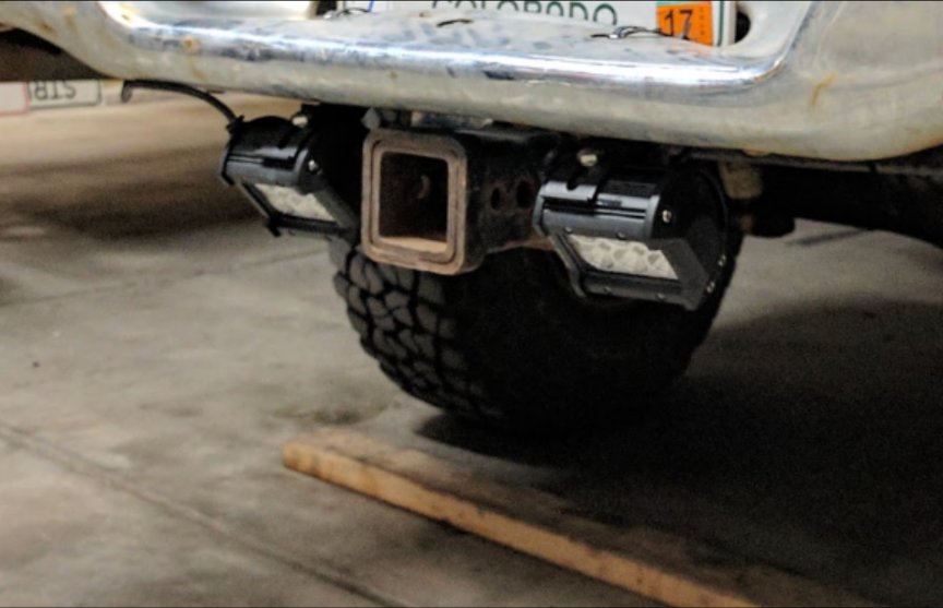

    I ran similar LED pods off of the reverse light wiring on both sides and had no problem with the fuse.
    I did rip them off on the trail though lol
    1996_2.4[OP] likes this.

    I saw those, but I only have a ball trailer hitch on my bumper, not one of those.

    That's ok, regardless of where you mount them they should be good to go tapped into the reverse light wiring.
    The light is a huge help in the dark :D
