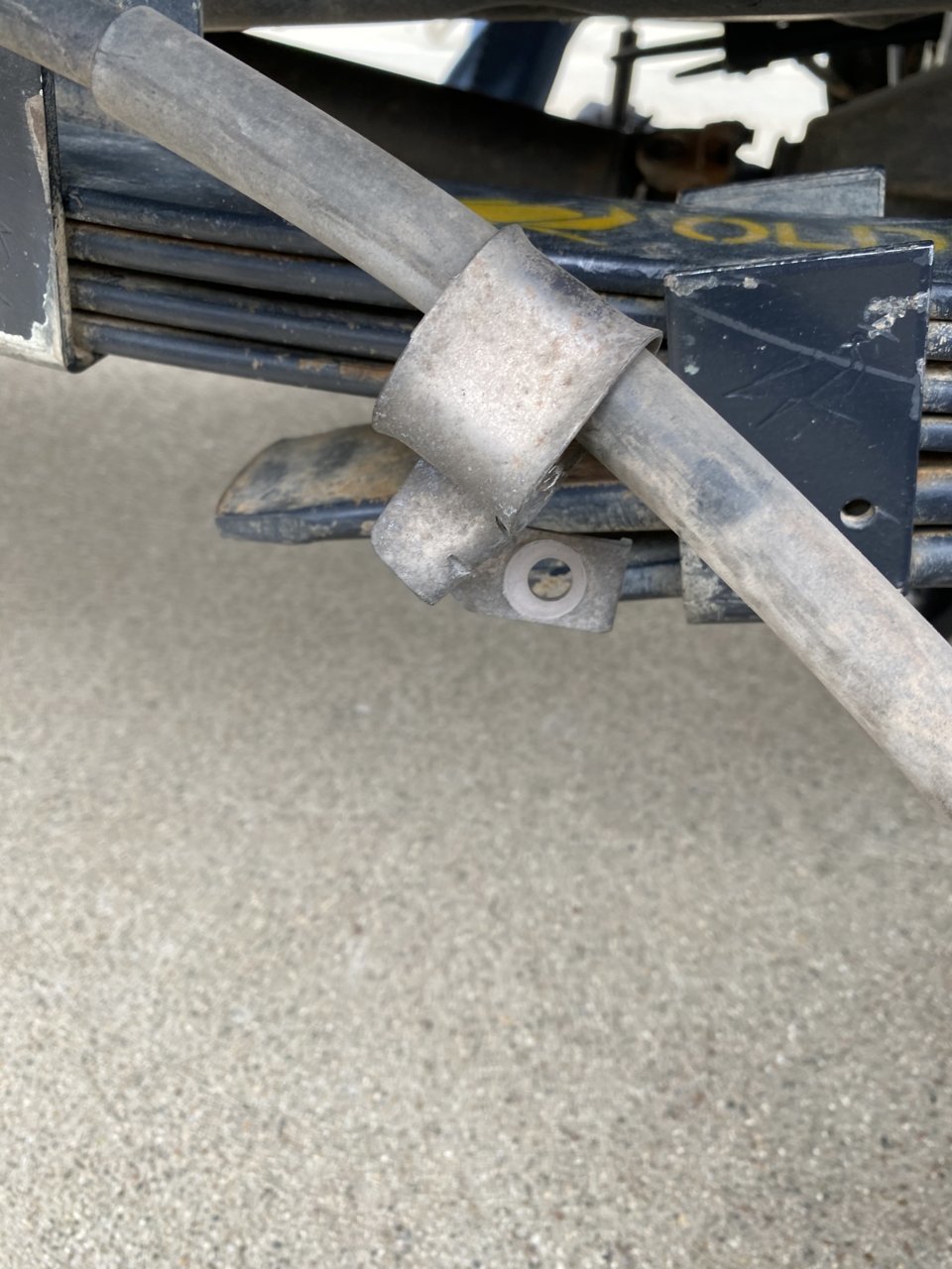

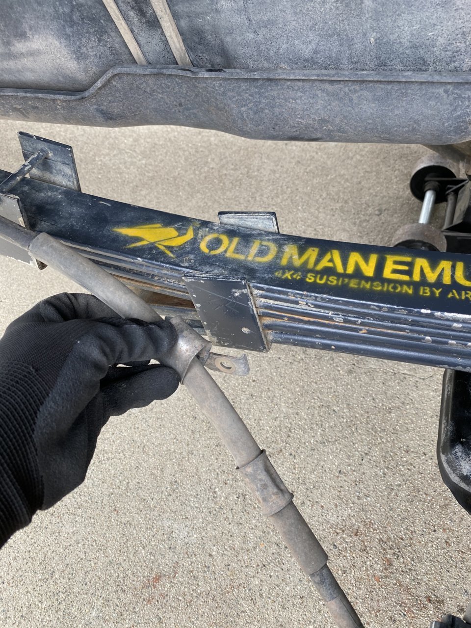

    I’m installing mine and they do not reach the tapped hole in the leaf pack bracket.
    tips?
