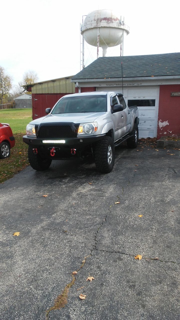

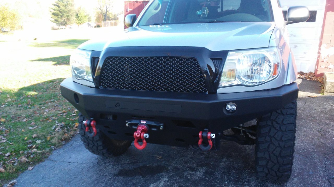

    I have a 68lb aluminum plate bumper...Pelfreybilt. Winch with synthetic line (1/7th the weight of steel cable) Aluminum skids, and relatively light sliders (for bolt on sliders...)
    With the use of aluminum, ALL my armor and winch is still less than that heavy steel bumper and winch.
    That dropped the front of my truck about 3/4". That's with OME 885X coils on 5100 Billstiens. A simple 1/2" poly top plate spacer restores it to pre-armor/winch ride height.
    You will need higher spring rate, regardless of actual "lift" or not just to maintain the ride height you now have.

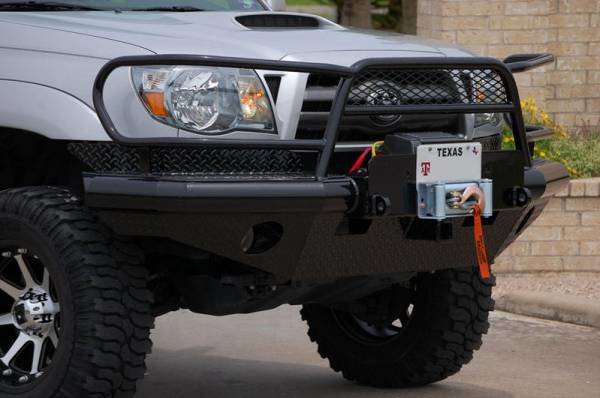

    Buy a demello offroad bumper or SOSconcepts, solid bumpers. Many companys make great strong plate bumpers that dont weigh 300 pounds, my bumper like 135 ISH and it weighed it down quite a bit. You are not gonna wanna go that heavy in the front especially if you drive highway a lot.

    abumperfrontview.jpg Most of the better brands of aluminum bumpers are formed in such a way that they're stronger than the truck frame itself. I've already had a couple solid "impacts" that rattled the truck and didn't leave a mark on the bumper. Wouldn't hesitate for a second to go aluminum again.
    This one is available with loop and headlight loops too.

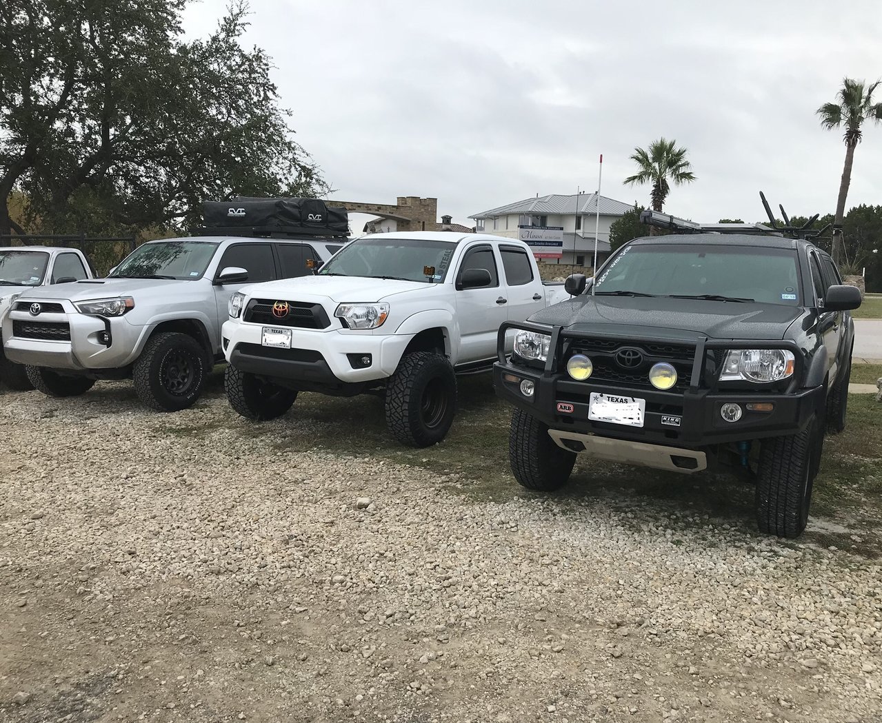

    ARB for the win! Ive hit a few deer in mine and its held up great. The ones for the 05-11s fit better than the 12-15s too. If you had a 12-15 id say steer clear, but this one fits like a glove. Also without a winch, it weighs about 125. I ran mine without upgraded suspension for a while, but you will notice the front end nose diving a little more on hard stops
