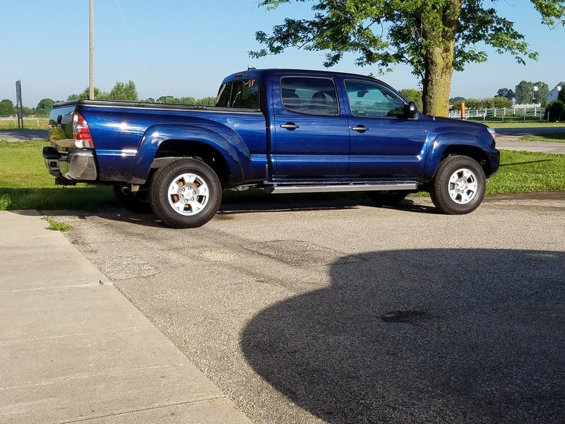

    I have a '12 base taco crew cab that has a slight downward front end slope, all stock it seems. I was looking into getting a pair of 5100 per some threads i saw on here. My question is if i do purchase those, do i have to get new coils? Or can i use stock? Will i need AAL's immediately in the rear or can i go without for a few weeks? I am a newb at all of this and i will be going to bed soon so may not respond till tomorrow morning. Thanks in advance.

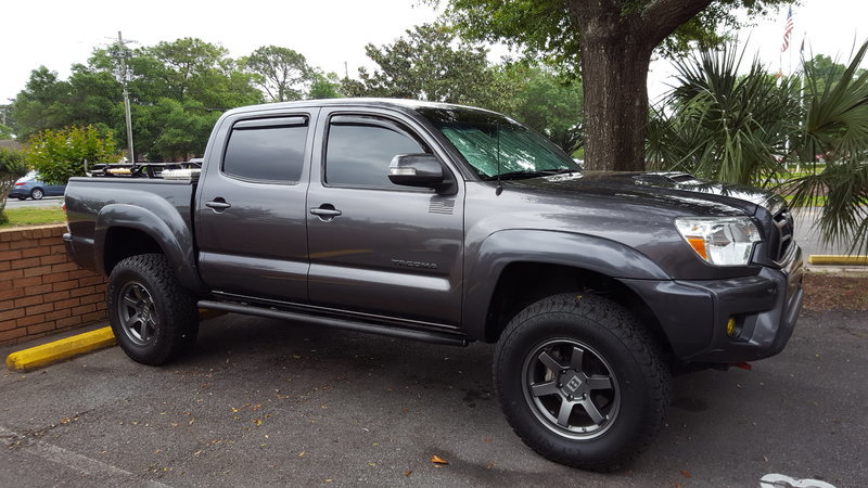

    OME 885s. You can get them on Amazon for $167. Here's mine with 885s and 2" AAL

    Nope, you have to disassemble them. The part that adjusts on the shocks is the part that the bottom of the spring rests on. You have to fully disassemble them, move that perch up or down, and then reassemble.
    No, not quite. If you use the 5100s with stock coils, you obtain the lift from the shock by preloading it. That means you're putting tension on the coil and that's what pushing the tire down, causing lift.
    With aftermarket coils such as 885s, you obtain the lift from the longer coil, and NOT the shock. This is why it rides smoother.
    So if you want to run aftermarket coils, you leave the front 5100s set to 0. The rear doesn't have coils, so if you want to lift the rear, you'll need an add a leaf, as well as longer shocks (5100s). Hope this makes sense.
