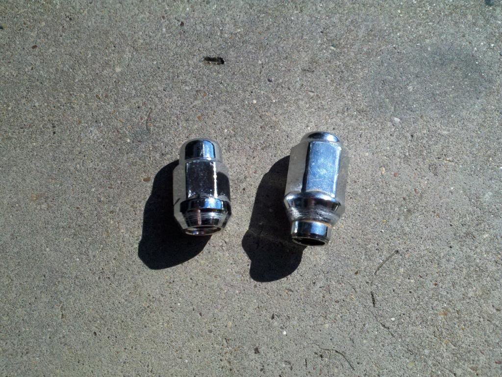

    the one on the right is the factory one.
    had to get the ones on the left since the factory ones don't work w/ the spare due to the part sticking out.

    Those are aftermarket type lugs. The one one the left is the acorn bulge style and the one on the right is the acorn extended thread. Don't know if those are factory as Toyota uses the type below as oem.

    the one on the right is what the 24 are that came on my truck w/ the tss/tx edition wheels.

    I need to ones on right. Long story but 2 stripped out of my wheel hub during a tire change. Toyota says they do not make them anymore. Does anyone know of a suitable replacement? Regular lug nots do not work due to the rims on this truck. They look just like the pic in the beginning of this thread. 2012 Tacoma TSS Sport.

    They should still be available aftermarket, called ET Thread.
    Gorilla offering in black: Amazon.com: Gorilla Automotive 21134ETBC Black 12mm x 1.50 Thread Size Chrome Finish Small Diameter 6-Lug Kit, (Pack of 24) : Automotive

    I had to buy a set of these (or similar like the ones posted a few posts above) to use for the aluminum alloy 4runner wheels that I put on my tacoma. Had to have the washer bottom.
