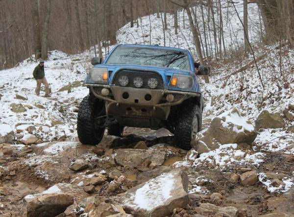

    Nooo-o-o-o...Aftermarket UCAs add caster, and increasing caster moves the tire forward in the fender well...he'll have more fitment issues up *front*.
    Easy solution for that - just get the bumper out of the way of the tires:
